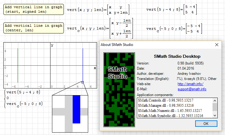

This demonstration (functions inspired by Jean) shows the problem:

Posting files help. Glad you didn't in this case as I am trying SMath out in Linux and appear to have another glitch with setting up the coordinate range in Linux. I assume you are using plot 2D. See attached 2D Graph.smz (2.81 KiB) downloaded 1533 time(s).
Yes, you are quite right. Sorry for being forgetful - off-by-1.sm (5.53 KiB) downloaded 1394 time(s).
Mike, in lieu of screen shot, usse appVersion
Thanks again! I still hasn't quite got used to this new handy feature.
Mike, how did you zoom in?
Entered the graph, then used Ctrl+Wheel (vertical zoom) / Shift+Wheel (horizontal zoom) while keeping mouse over the graph.

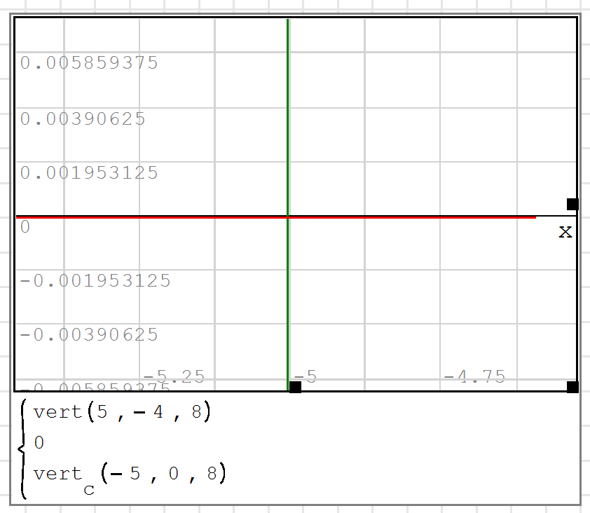

It's a zoom graphics issue. If you zoom into the axis, the "Line" is right over the grid line
I just redid an old Gateway laptop ... Linux Mint 17.3 and Windows Vista 32 bit. Your file and my file are identical in the graphics ... when I zoom in, the "line" is clearly over the grid. Look at the zoomed in graph 2D Graph.smz (3.11 KiB) downloaded 1566 time(s).
BTW, thanks for showing me that the descriptor can be moved. Still figuring out how to do it right as I did it by double clicking on the right edge. Sometimes it goes to the right, others to the left ...
No, looking at zoomed graph, and enlarging screenshot, I still see the offset.
... the descriptor can be moved. Still figuring out how to do it right as I did it by double clicking on the right edge. Sometimes it goes to the right, others to the left ...
When you enter the descriptor, it shows three vertical dots to the left. You may grab these and move horisontally.
I was talking about the "zoom in" to the grid/line that shows the "Pixel delta" Capture.PNG. The CRTL+Wheel just changes the scale on the graph.
2D Graph.sm (7.64 KiB) downloaded 1376 time(s).
Looks like it depends on the computer ...My work computer shows the offset
Stand corrected:
... explain more about the image vertical lines:
The image was not properly stretched,...Jean
I stretched my zoomed in graph to the right ... the "pixilation" went away. This explains why my full graph did not show the pixilation issue ...

Oh, sorry, I misunderstood you. English isn't my native tongue, you know.
Actually, I just used Paint.Net to zoom in, then made another printscreen and combined. A bit of magic

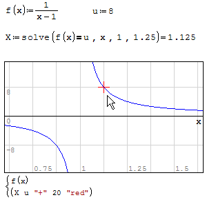

I think this would be a second example. I've tried to stretch and zoom in as feasible.Graphics off.sm (3.96 KiB) downloaded 1343 time(s).
From what I can tell, the error is in the "arrow" size ("20" )[Change the arrow to an x and it shows the same error]. If I make it 1, it appears to hit the right number. This would need to be fixed as it "shows" the wrong location.
The only way to make it "look" correct, so far, is to use a "+" sign.

Anyone else seeing this issue?

There is no issue in there, just plotting coincidence wrt graphic package.
Coincidence that appears in any system. The only symbols that will "center"
on a plot trace are:
(X,Y,".",size,"color")
(X,Y,"o",size,"color")
(X,Y,"+",size,"color")

Being able to do the "arrow" or the "less than" symbol would have been nice.

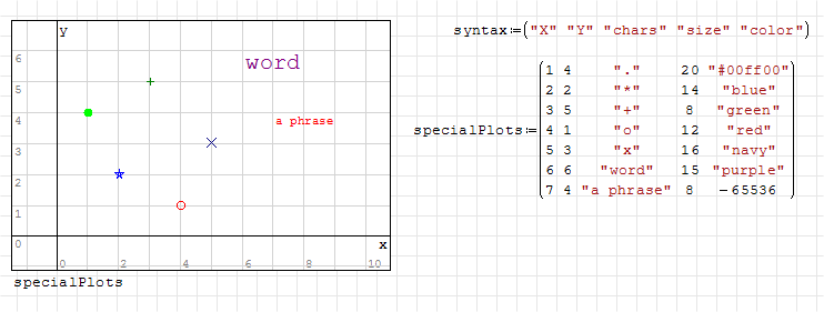

Correct; also, you can use "*" and "x" (wiki: https://smath.com/wiki/Graphs.ashx#SpecialPlots)
Quote
  • Special characters (case sensitive) have position fixed on center on the given coordinates: + . * o x;
  • Words, phrases or non-special characters have top-left corner of (virtual) textbox fixed on the given coordinates;

I missed this
Quote
#18 Posted: 4/13/2016 9:00:36 PM
Too many gadgets is like not enough. Make a nice arrow in Paint, slide the plot over the arrow.
