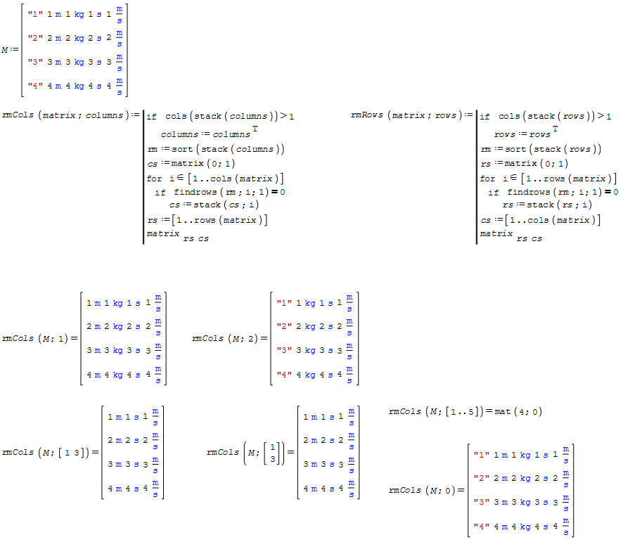

#3 Posted: 9/22/2022 7:02:40 AM
Something like this?
rmRows_rmCols.sm (35.17 KiB) downloaded 1371 time(s).

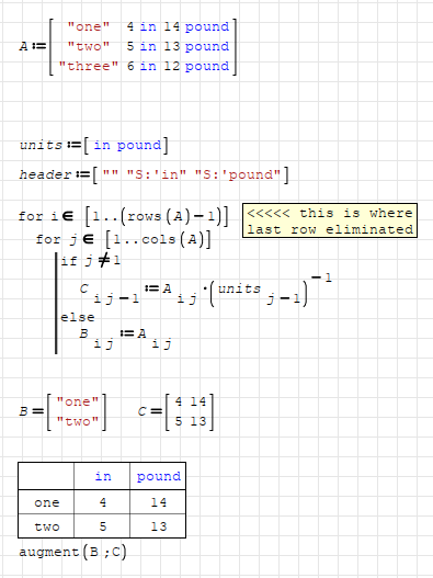

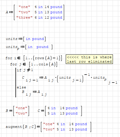

#4 Posted: 9/22/2022 11:16:00 AM
127 likes in 342 posts.
I believe that rfreund wanted to keep the units of measurement set. I take Davide's solution and I add a trick (I think he had been offered by Overlord or Razonar or perhaps from both).
However, I still have to solve for the strings. Furthermore, if we cancel the columns instead of the lines we should build the units of measurement of the matrix resulting with the same method.
rmRows_rmCols_units.sm (15.7 KiB) downloaded 1304 time(s).

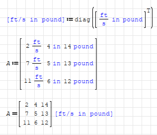

#5 Posted: 9/22/2022 7:14:03 PM
600 likes in 1,381 posts.
I first see usage of diag() for units by Razonar, then just wrote it as in your example.
Another way is using pseudo units, but this is also not interchangeable.
Again, these are not conventional ways. Just holding your left ear with your right hand.
And there is no solution for string column I guess.
matrix mixed units.sm (9 KiB) downloaded 1290 time(s).

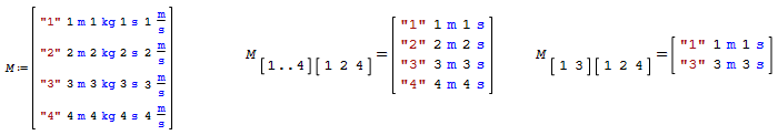

#6 Posted: 9/23/2022 4:26:49 AM
1,362 likes in 2,276 posts.
One might use vector-valued indices.
rmRows_rmCols_Kr.sm (7.87 KiB) downloaded 1322 time(s).

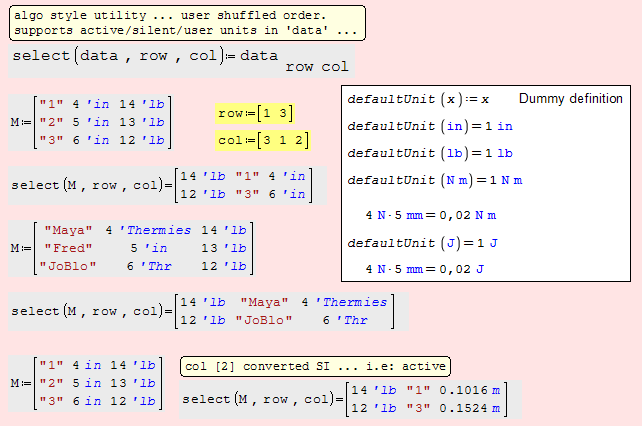

#15 Posted: 11/16/2022 8:51:17 AM
Yes, you can remove the row or column, but no you cannot get it to display in non-SI units.
Smath is delivered with silent units or active SI ...
... silent units as required
Page4 Delete Col-Row.sm (15.27 KiB) downloaded 1441 time(s).

#18 Posted: 11/17/2022 11:38:10 AM
Jean - it took me a minute to understand "silent-units" as I thought the apostrophe in front of the unit solved the unit "display" issue. I guess it does if you only want it to "look correct". Thanks for your efforts.
Silent mode disables the SI unit sub-processor.
Don't miss visiting this great matrix shuffling utility.
Cheers ... Jean.
Utilities Matrix Shuffle.sm (12.31 KiB) downloaded 1315 time(s).
#19 Posted: 11/17/2022 11:50:17 AM
... this clean version.
Utilities Matrix Shuffle.sm (14.73 KiB) downloaded 1354 time(s).
