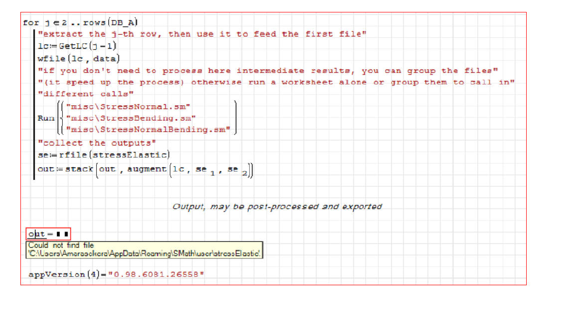

#6 Posted: 8/27/2016 2:28:06 AM
NDTM Amarasekera
NDTM Amarasekera
130 likes in 352 posts.
  • requirements: SMath Studio 0.98.5935 or later;
  • installation: SMath Studio: Tools
  • Problem in 98.6081?

    Problem in 98.6081?
    Hello ndtma,
    yes, seems there are isSies with the process handle. I'm looking to find the cause and if I can solve it
    #10 Posted: 8/29/2016 1:05:21 PM
    Issue found.
    edit: fixed in SS 0.98.6179

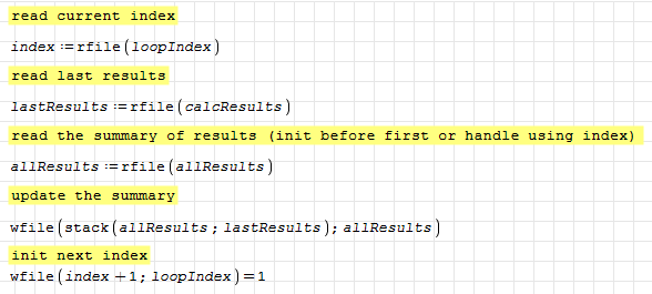

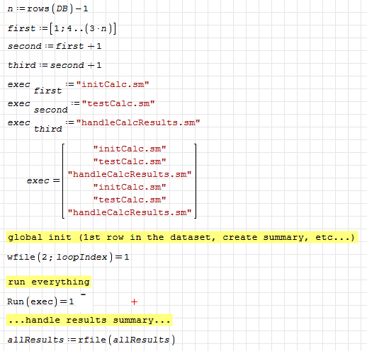

    Currently each Run function triggers a new instance of SMath Studio; this means that all the initialization process must be done every time, rising the execution time. What you can try is to change the logic to start a single run with multiple worksheets, and init/finalize each loop step in a dedicated file.
    new loopSheet.sm
    initCalc.sm
    handleCalcResults.sm

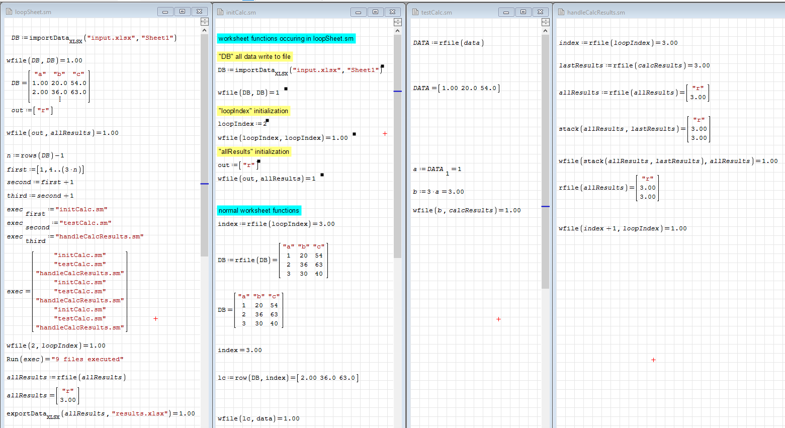

    #13 Posted: 11/2/2018 2:32:57 PM
    Kyle Sullivan
    Kyle Sullivan
    2 likes in 9 posts.
    Thanks for the response Davide.
    So I went ahead and tried out your idea, it does solve the only 'running' once issue and finishes the script in 6 seconds no matter what.
    But now I have the issue where the Run(exec) command does not seem to be running all the scripts in the exec matrix, or somehow it's only saving the first 'calcResults' in 'allResults'. That said, I was successful in manually looping the 3 sheets, so I thin something is going on incorrectly in the run(exec) line.
    You can see what I did in the gifs below if you open them full size in a new tab..
    Thoughts?
    Calc completed successfully by manually looping the 3 sheets:
    Manual loop method works
    Calc running with loop sheet, only records first row result:

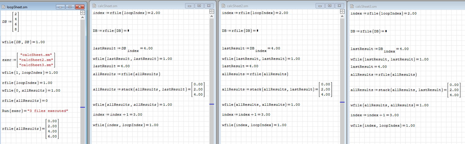

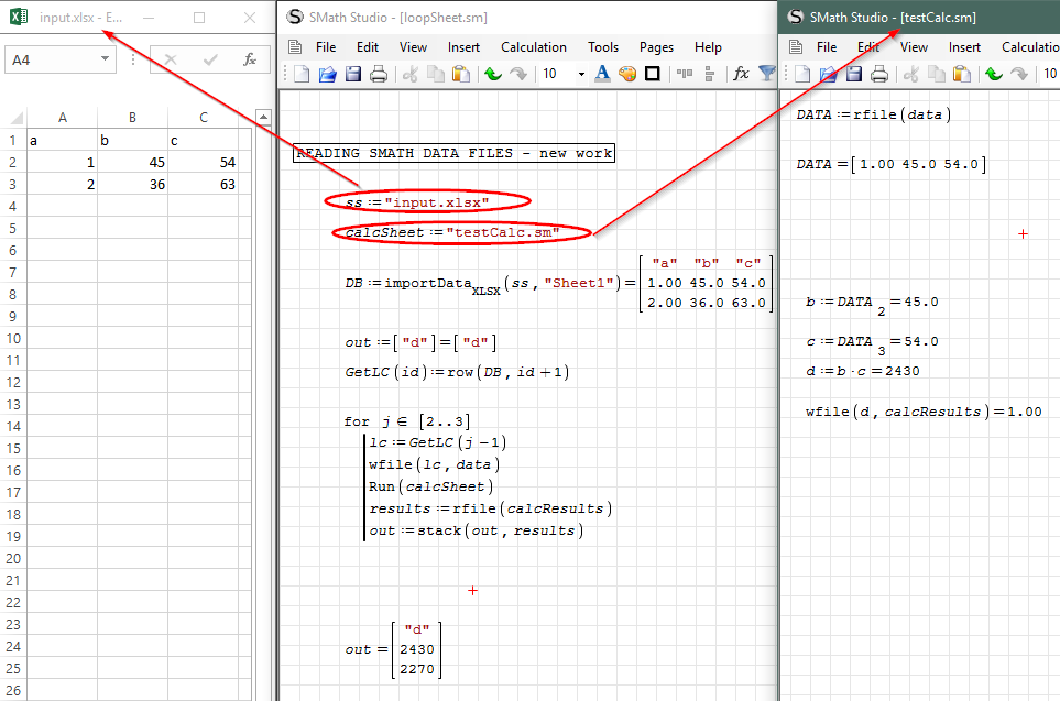

    I reran it after saving everything and the same thing happened..here's a non-gif image and the files. I guess Davide's example ran fine so I should be able to figure this out haha. I'm currently troubleshooting so stay posted
    testCalc.sm (3.48 KiB) downloaded 1706 time(s).
    handleCalcResults.sm (5.08 KiB) downloaded 1711 time(s).
    initCalc.sm (9.58 KiB) downloaded 1653 time(s).
    input.xlsx (8.07 KiB) downloaded 1134 time(s).
    loopSheet.sm (10.61 KiB) downloaded 1651 time(s).

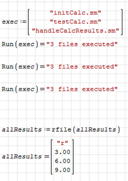

    This gave me what I want..
    Run(exec)
    Run(exec)
    Run(exec)
    I quit, there's something with run() only running files if they have a different name, or the Run(exec) is called again (like above). I created a new, simpler example.. Below shows that if exec is defined with 3 separate but identical calc.sm files (calc1.sm, calc2.sm, etc) then run(exec) will run all 3 files and the allResults var is fully populated. If I define exec as a vector with all the same calc.sm files then it won't work and allResults will just end up with the first result.
    calcSheet.sm (5.68 KiB) downloaded 1671 time(s).
    loopSheet.sm (5.49 KiB) downloaded 1677 time(s).
