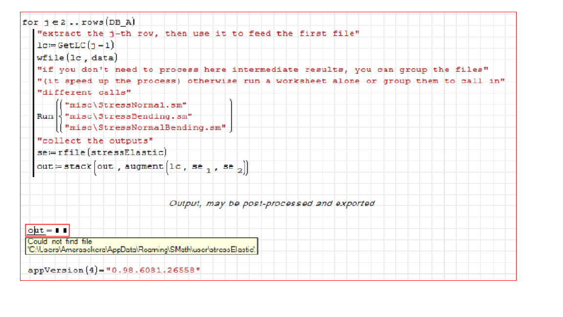

  • Problem in 98.6081?

    yes, seems there are isSies with the process handle. I'm looking to find the cause and if I can solve it
    #10 Опубликовано: 29.08.2016 13:05:21
    Issue found.
    edit: fixed in SS 0.98.6179

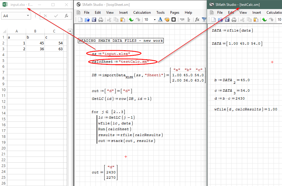

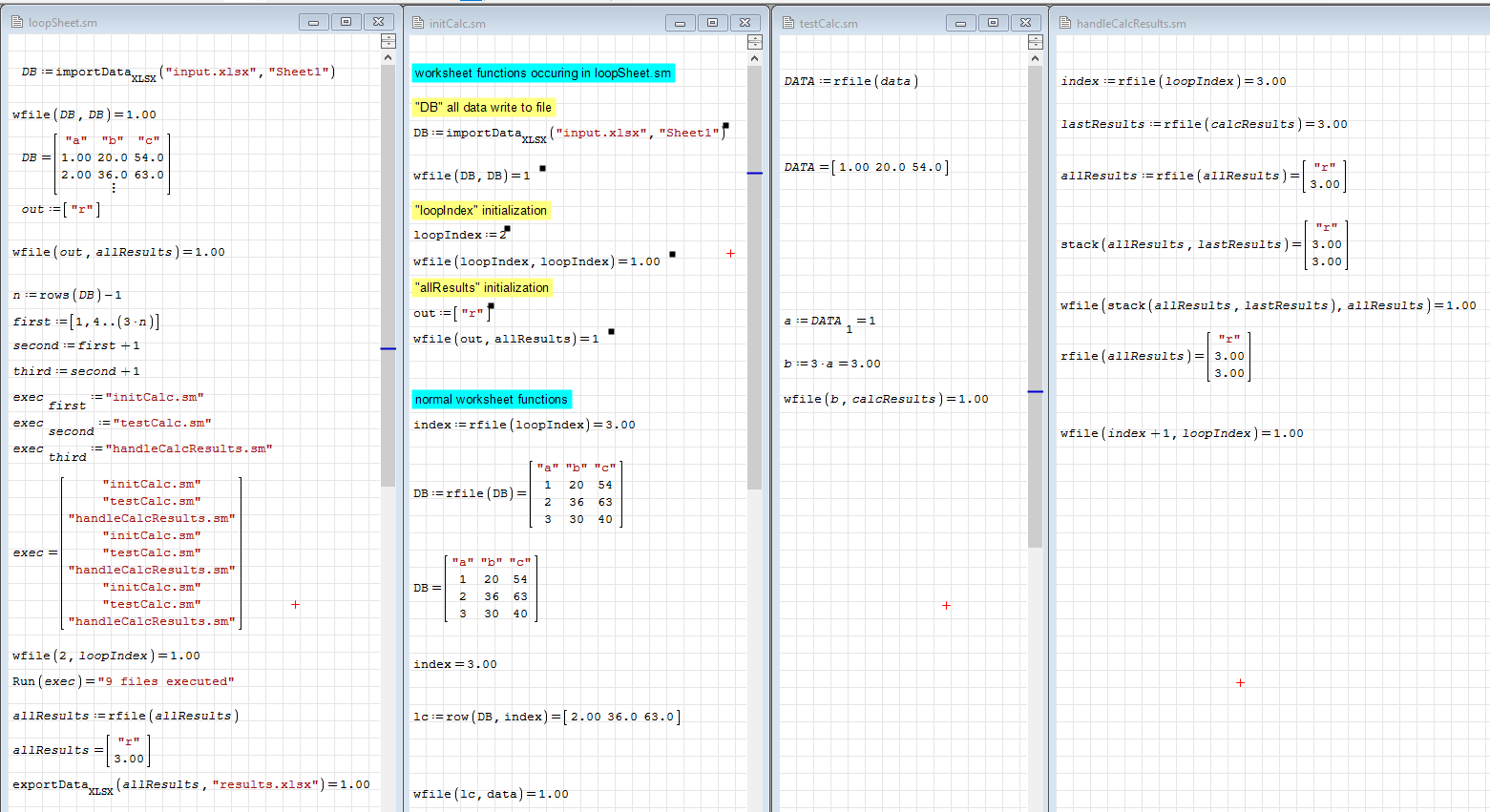

    Hi Davide, I created my own example with a 3x3 excel table and it takes about 6 seconds for the "Run" function to execute each row of test data during the for loop. The smath sheet it's running contains 2 variables multiplied together and output as a variable 'd'. Your entire example runs in 22 seconds, with definitely a bit more complexity, but not much. Any ideas here? I'd like to run 400 rows of data (load cases for different members) through a calc sheet and collect the results, just like you've done (except only one calc sheet, not 3 like you've done).
    thx!

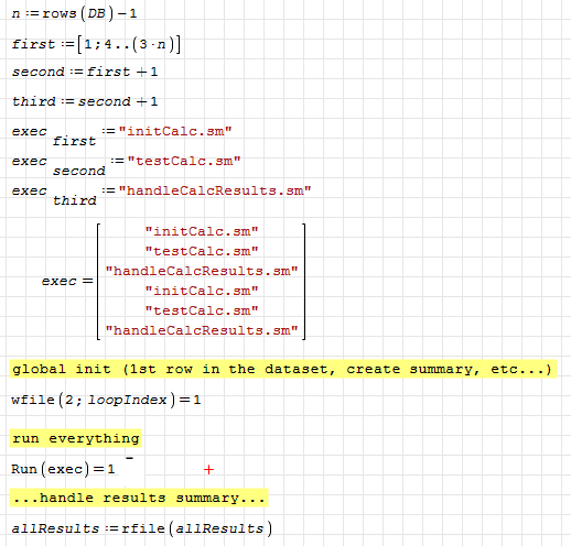

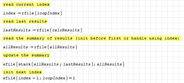

    Currently each Run function triggers a new instance of SMath Studio; this means that all the initialization process must be done every time, rising the execution time. What you can try is to change the logic to start a single run with multiple worksheets, and init/finalize each loop step in a dedicated file.
    new loopSheet.sm
    initCalc.sm
    handleCalcResults.sm
    Kyle Sullivan 02.11.2018 13:55:00

    Thanks for the response Davide.
    So I went ahead and tried out your idea, it does solve the only 'running' once issue and finishes the script in 6 seconds no matter what.
    But now I have the issue where the Run(exec) command does not seem to be running all the scripts in the exec matrix, or somehow it's only saving the first 'calcResults' in 'allResults'. That said, I was successful in manually looping the 3 sheets, so I thin something is going on incorrectly in the run(exec) line.
    You can see what I did in the gifs below if you open them full size in a new tab..
    Thoughts?
    Calc completed successfully by manually looping the 3 sheets:
    Manual loop method works
    Calc running with loop sheet, only records first row result:
    #14 Опубликовано: 02.11.2018 15:52:52

    Hi K. Gif shows that you modify iniCalc.sm (disabling some calcs) but don't save it, so others SMath files read the original iniCalc.sm, not the modified. Is this the issue or I'm are not understanding something else?

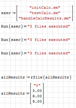

    I reran it after saving everything and the same thing happened..here's a non-gif image and the files. I guess Davide's example ran fine so I should be able to figure this out haha. I'm currently troubleshooting so stay posted
    testCalc.sm (3,48 КиБ) скачан 1706 раз(а).
    handleCalcResults.sm (5,08 КиБ) скачан 1711 раз(а).
    initCalc.sm (9,58 КиБ) скачан 1653 раз(а).
    input.xlsx (8,07 КиБ) скачан 1134 раз(а).
    loopSheet.sm (10,61 КиБ) скачан 1651 раз(а).
    This gave me what I want..
    Run(exec)
    Run(exec)
    Run(exec)

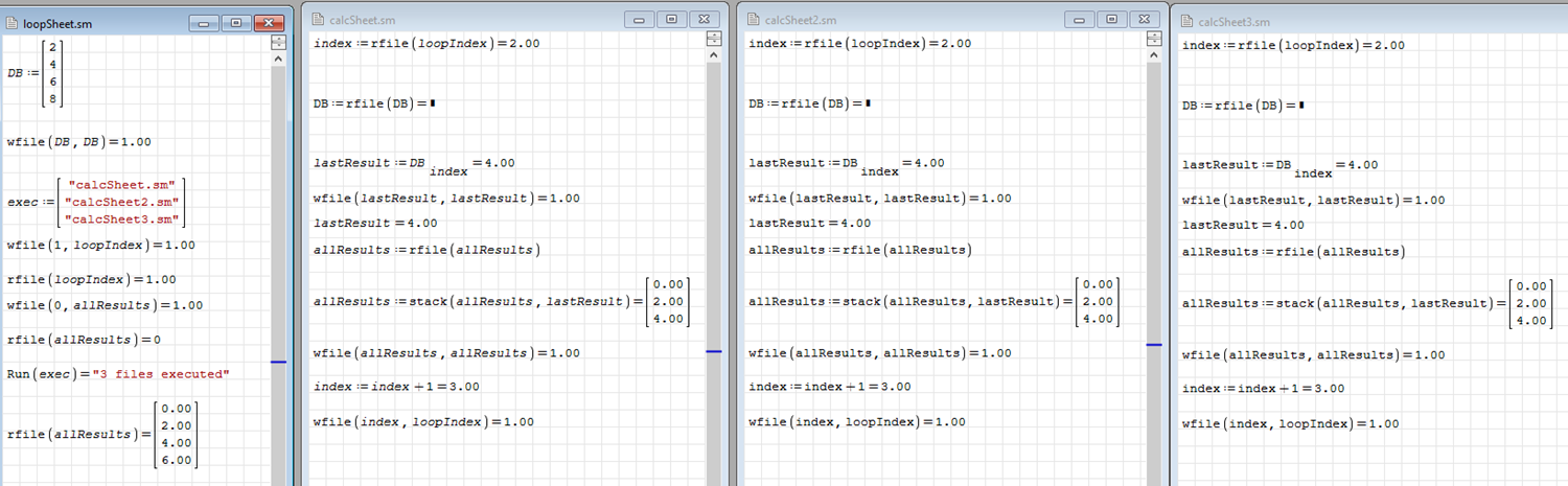

    I quit, there's something with run() only running files if they have a different name, or the Run(exec) is called again (like above). I created a new, simpler example.. Below shows that if exec is defined with 3 separate but identical calc.sm files (calc1.sm, calc2.sm, etc) then run(exec) will run all 3 files and the allResults var is fully populated. If I define exec as a vector with all the same calc.sm files then it won't work and allResults will just end up with the first result.
    calcSheet.sm (5,68 КиБ) скачан 1671 раз(а).
    loopSheet.sm (5,49 КиБ) скачан 1677 раз(а).
