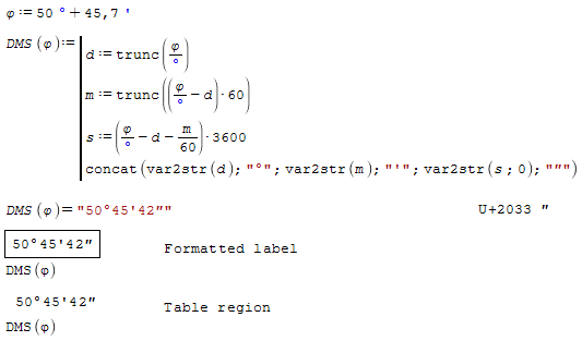

#2 Posted: 4/1/2018 7:30:16 PM
I don't know if my solution is smarter, but the display is closer to what you want. The seconds symbol should be " but that doesn't work.
DMS.sm (9.78 KiB) downloaded 1200 time(s).
sergio 4/2/2018 5:15:00 AM

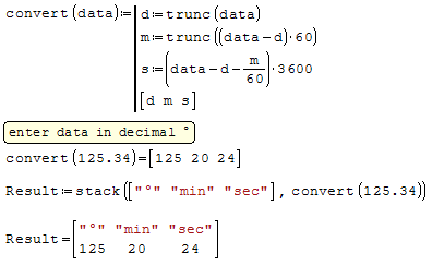

#3 Posted: 4/1/2018 11:26:38 PM
WroteThanks in advance for every idea!
Maybe you can set as you wish, getting inspired from Martin guidance.
Maths Convert [deg, min, sec].sm (4.76 KiB) downloaded 1061 time(s).
