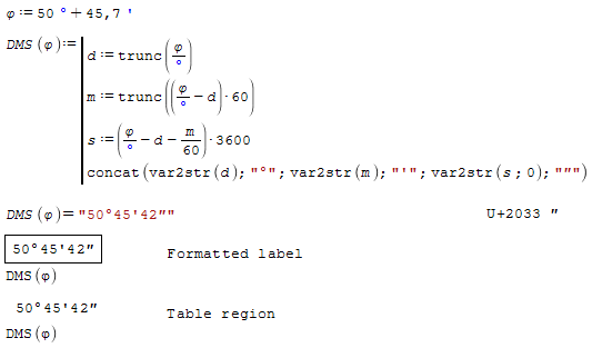

I don't know if my solution is smarter, but the display is closer to what you want. The seconds symbol should be " but that doesn't work.
DMS.sm (9,78 КиБ) скачан 1200 раз(а).

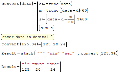

Maybe you can set as you wish, getting inspired from Martin guidance.
Maths Convert [deg, min, sec].sm (4,76 КиБ) скачан 1061 раз(а).
