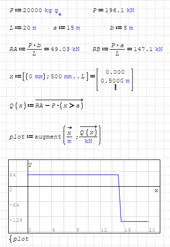

Good morning,
I'm new to smart studio and I'm trying to plot the graph for this function of a bi-supported beam but I can't
whyplot.sm (7.98 KiB) downloaded 1041 time(s).

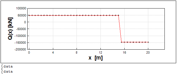

Something like that. The X-Y Plot plugin doesn't have advanced capabilities for working with units.
Unlike Mathcad, we have only one field for describing the graph. For this reason, we can only learn about the X variable from this description. For this, it must be undefined. The component looks for undefined variables in the expression and uses them to determine how to plot a graph. If you define the variable x, then the component will not understand how to plot the graph. The tilde sign (~) helps him with this as an analogue of the range variable in Mathcad.
whyplot (uni).sm (9.75 KiB) downloaded 1079 time(s).
Click to enlarge
You have an incorrectly written expression:
Click to enlarge
We usually plot the graph like this:
Click to enlarge

#3 Posted: 12/27/2021 11:19:06 AM
Zap units for the plot.
whyplot (else).sm (13.03 KiB) downloaded 1114 time(s).
Same approach with embedded 2D plot.
This would be awesome if 2D plot supports tilde sign (~) ranges.
