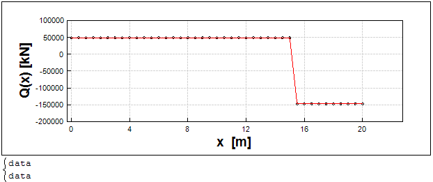

You have an incorrectly written expression:
Click to enlarge
We usually plot the graph like this:
Click to enlarge

#3 Опубликовано: 27.12.2021 11:19:06
I'm new to smart studio and I'm trying to plot the graph for this function of a bi-supported beam but I can't
Zap units for the plot.
whyplot (else).sm (13,03 КиБ) скачан 1271 раз(а).

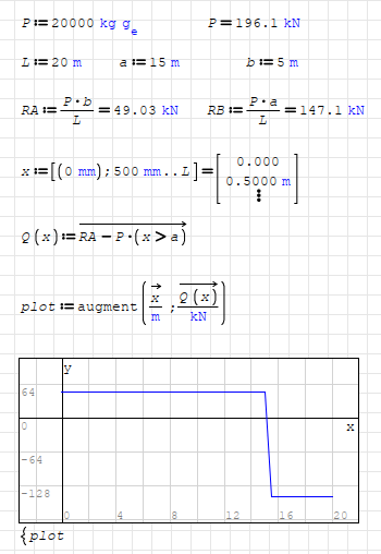

#5 Опубликовано: 27.12.2021 17:45:59
Same approach with embedded 2D plot.
The tilde sign (~) helps him with this as an analogue of the range variable in Mathcad.
This would be awesome if 2D plot supports tilde sign (~) ranges.
