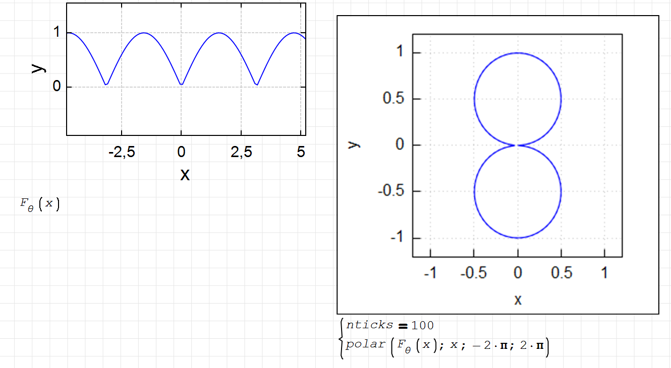

Hi SMath team,
how to plot a polar diagram of radiated fields of infinitesimal linear wire?
Could you plase help me with this topic.
Bes regards,
Andrey
Please see you the file Herzt_Dipole_Polarediagram.sm (328.05 KiB) downloaded 1351 time(s).
#2 Posted: 10/18/2021 8:49:34 AM
1,362 likes in 2,276 posts.
You can use the Maxima Draw2D region. Sorry for the high resolution screenshot, this seems to be a new feature of the smath solver or some other dpi glitch on my system (the screen was not high dpi where the shot was taken from, however).

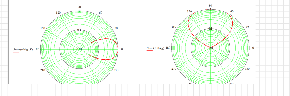

Hello Smath users,
do you have experience or any idea, who to create a polar plot like Mathcad, as shown on the picture?
I need a dB or Log - scale for radius and marking of directions
Thank you for you help.
Best regards,
Andrey

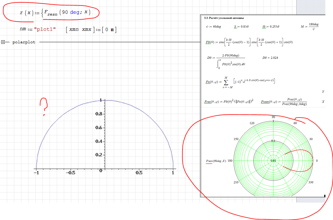

#7 Posted: 11/15/2021 6:26:39 PM
Andrey
Andrey
1 likes in 44 posts.

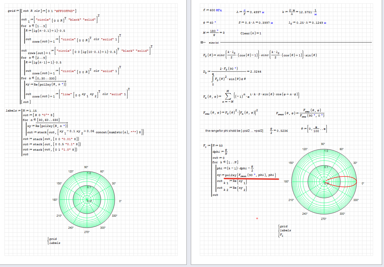

Dear SMath users and developers,
unfortunately I did not succeed to create the graph as polar diagram with the help of Maple plugin.
I have tried different options, with Maxima plugin it works, with Maple unfortunately not.
Just one thing. How can I create the polar lines and circular lines (dB or Log20 or Log10) with different step sizes?
A desirable is the one polar diagram as on the picture Calculation of the corner antenna.sm (423.36 KiB) downloaded 1302 time(s).
That is unfortunately a pity that there is not available a Polar-Diagram set s a normal tool or plugin.
Best regards,
Andrey

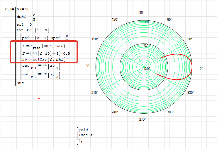

#8 Posted: 11/16/2021 7:05:21 AM
1,558 likes in 1,868 posts.

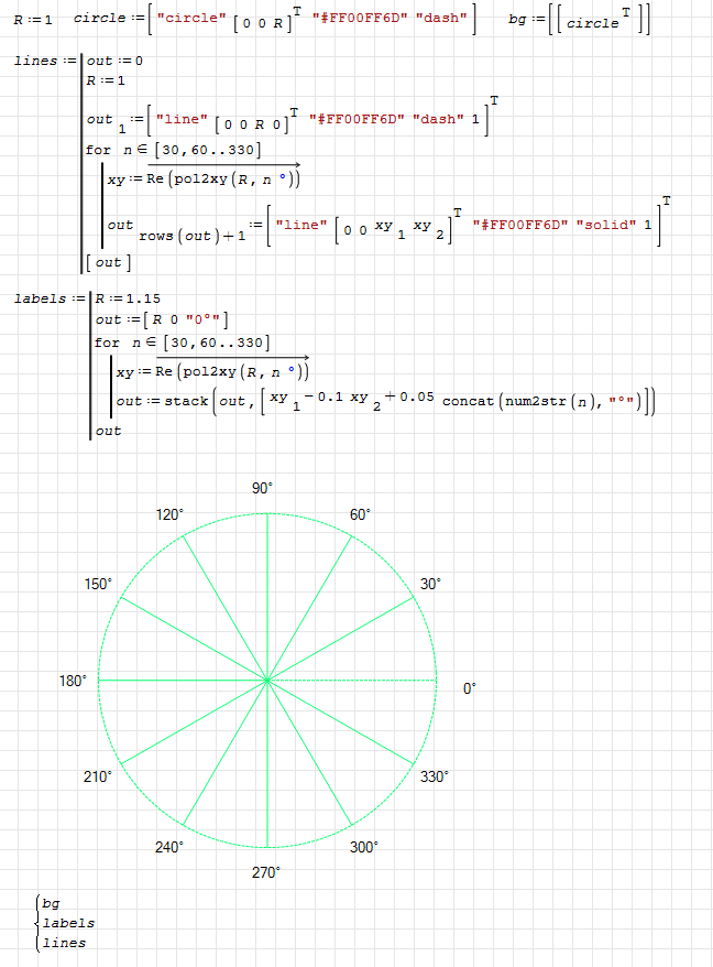

You can use X-Y Plot for this. The function must be drawn with a coordinate transformation in the form of a matrix.
XYPlot. Shapes. Polar grid.sm (11.58 KiB) downloaded 1303 time(s).
XYPlot. Draw shapes.sm (19.85 KiB) downloaded 3297 time(s).
XYPlot. Draw shapes.pdf (92.91 KiB) downloaded 2311 time(s).
#9 Posted: 11/16/2021 9:11:53 AM

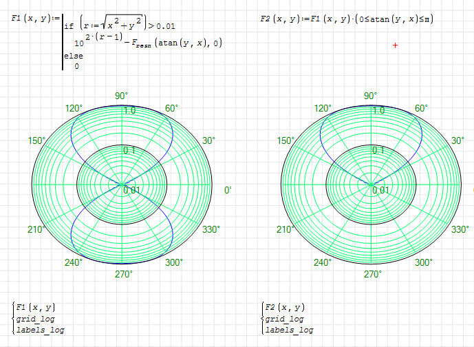

Something like this, but you need to display the logarithm of the curve.
XYPlot. Shapes. Polar grid.sm (34.66 KiB) downloaded 1298 time(s).
#10 Posted: 11/16/2021 9:31:30 AM
Such conversions are fine, but I'm not sure if they are correct.

#12 Posted: 11/16/2021 12:28:00 PM

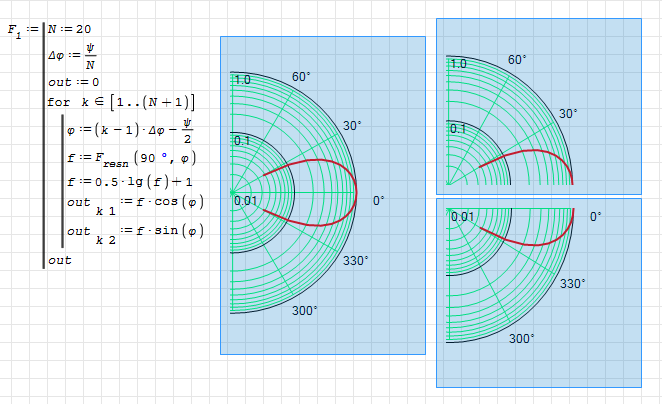

График можно двигать и ограничивать, используя настройки X-Y Plot.
XYPlot. Shapes. Polar grid.sm (38.47 KiB) downloaded 1236 time(s).
XYPlot. Shapes. Polar grid.pdf (124.28 KiB) downloaded 826 time(s).

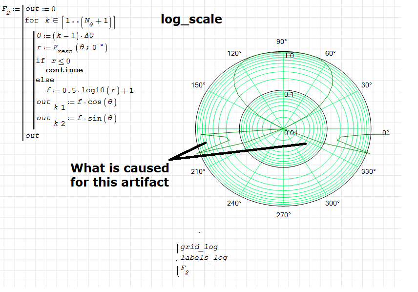

мне все еще нужно обратиться к вам за помощью с Log-Polar Plot.
Я столкнулся с проблемой, как сделать полярный график с логарифмической шкалой для Theta.
Я всегда вижу отрицательное значение r в начале и в конце спискса.
Мне пришлось провести нормализацию и проверки амплитуды на отрицательный радиус перед взятием логарифма, но это не помогло.
Как по Вашему, что может быть причиной такого поведения для графика по углу Theta?
Calculation of the corner antenna_2.sm (499.88 KiB) downloaded 1394 time(s).
Спасибо, Андрей

#15 Posted: 11/21/2021 7:59:03 PM
Можно так.
File not found. File not found. File not found.
#16 Posted: 11/23/2021 5:15:51 AM
Andrey
Andrey
Вячеслав, cпасибо, вы мне очень помогли.
С уважением,
Андрей
#17 Posted: 11/23/2021 1:19:11 PM
1,139 likes in 1,805 posts.
Можно так.
There is there a very mysterious r> 0.01. My explanation is that, first of all, you have to make sure that the argument for log10 is positive, but then you have to verify that in the polar graph it is f> 0, because in polar coordinates only positive values of the position vector module are considered. This implies that f = 0.5 * log10 (r) +1> 0 is needed, from which solving for r we have the mysterious condition r> 0.01.
Addendum:
The original range for the graph is 0 < theta < 180º . Outside of that domain the problem is not defined, or simply does not matter. Viacheslav restricted the domain by imposing y> 0, which is correct, but the following form shows a little more clearly how the transformation of coordinates from Cartesian to logarithmic polar is done, and then imposing the original condition on the domain, so that XY plot just plot in the desired range.
