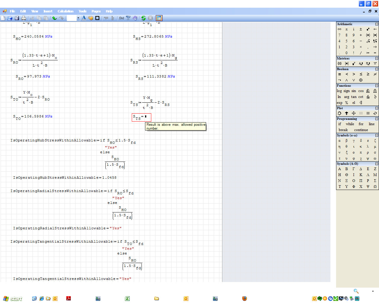

Error: Result is above max allowed positive number - datsnl - Messages

#4 Posted: 5/16/2013 7:08:29 AM
Hello Dharmit,
I understand.
Just send me a private e-mail (the last line of any post) or directly to omorr@uns.ac.rs.
Before you send it to me, you could just try right click on the regions and choose Optimize|Numeric, or enclose the calculation in eval() - right hand side of the assignment ( := ). This will work most of the time if you just work strictly with the numerical values.
I understand.
#5 Posted: 5/16/2013 5:46:53 PM
Hi Omorr,
When I right clicked on the region and selected Optimize, it was already selected to Numeric, so I didn't change anything there.
But your eval() worked like a charm.
Thanks for your help.
Dharmit

#6 Posted: 5/17/2013 1:00:41 AM
Nice to hear that
I marked this topic as solved.
EDIT: Unfortunately, I can not explain and I do not know why and when is this happening. This is some internal SMath problem and there is no other way except to use it in these kind of problems.
