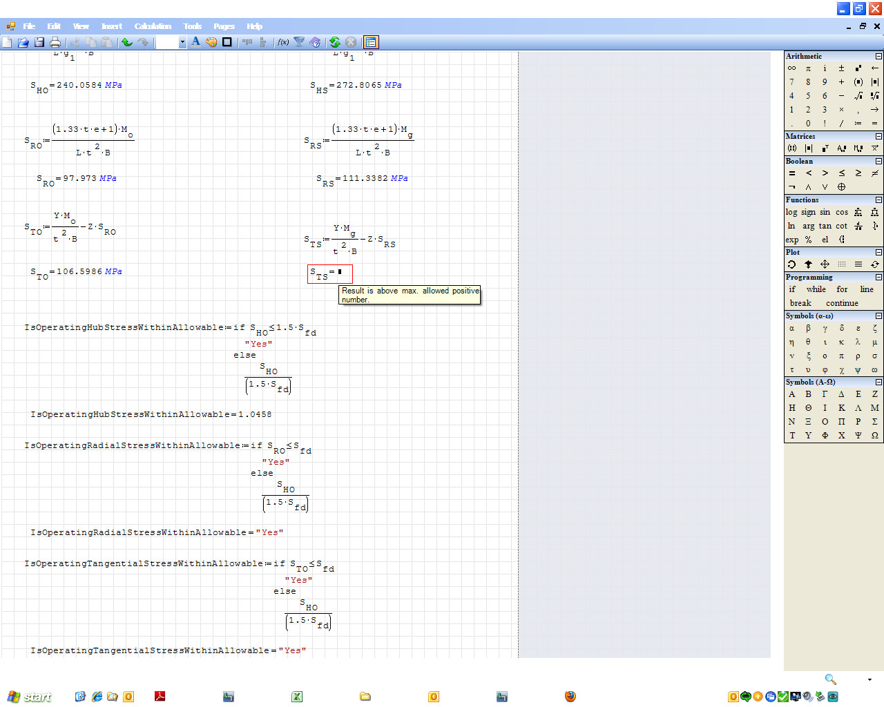

I am getting error "Result is above max allowed positive number". What does that mean and how to resolve it.

Before you send it to me, you could just try right click on the regions and choose Optimize|Numeric, or enclose the calculation in eval() - right hand side of the assignment ( := ). This will work most of the time if you just work strictly with the numerical values.

When I right clicked on the region and selected Optimize, it was already selected to Numeric, so I didn't change anything there.
But your eval() worked like a charm.

EDIT: Unfortunately, I can not explain and I do not know why and when is this happening. This is some internal SMath problem and there is no other way except to use it in these kind of problems.
