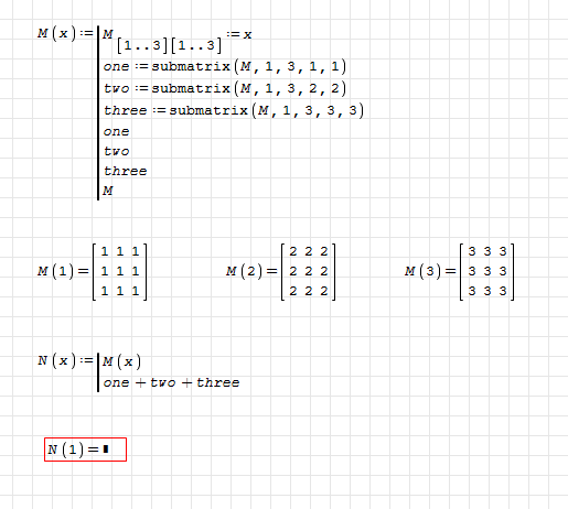

Of course it is possible.
variables.sm (19.8 KiB) downloaded 1201 time(s).
cloud preview

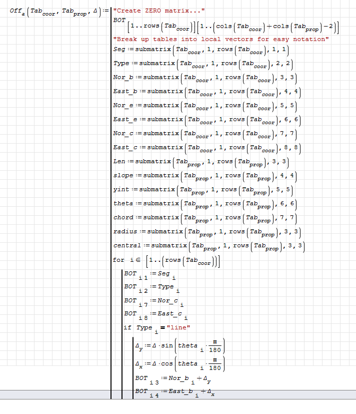

Thanks for the responses, but I still thinking that I what I was hoping (not expecting) to achieve is not possible.
I am just working with some data table (matrix) calculation and manipulation. And, though simple, the functions / routines that I have come up with are rather long and can extend over the page breaks, which is making portions of them difficult or impossible to see.
My hope was that if I could break the longer function into a few smaller functions, then I could control the page break locations, as well as make the local equations more user-friendly (for checking) by having the local variables (and their values) pass from one embedded function to the next.
But I don't think the local variables will pass between the functions that way. :*(
function3 (x) = function2 (function1 (x))
Off_b = Off_a (names (table1, table2, value)) in the attached worksheet
piecewise - forum1.sm (72.2 KiB) downloaded 1150 time(s).

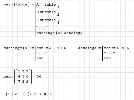

... My hope was that if I could break the longer function into a few smaller functions, then I could control the page break locations, as well as make the local equations more user-friendly (for checking) by having the local variables (and their values) pass from one embedded function to the next.
But I don't think the local variables will pass between the functions that way. :*(....
I believe you can do this, but you have to pass the function and their parameters in seperately. I do this for my Worst Case Analysis tool set I created which you can find here: https://en.smath.com/forum/yaf_postsm47624_Worst-Case-Analysis-Toolset.aspx#post47624
You do have to be careful of how you define the function and it's inputs, but it works. Attached is a simple example as well using pythagorean theorem. File not found.File not found.
