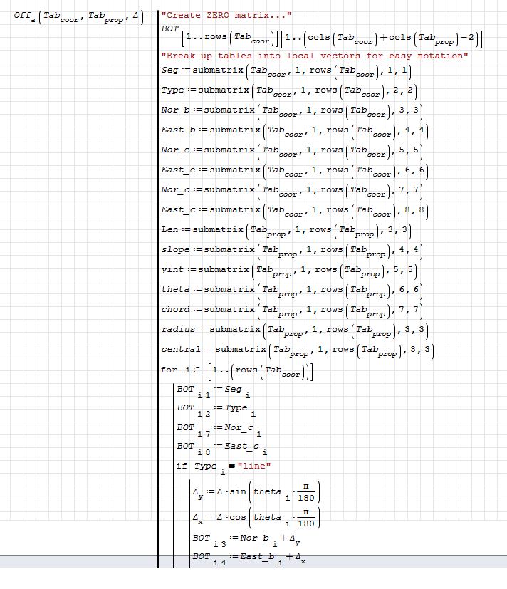

Thanks for the responses, but I still thinking that I what I was hoping (not expecting) to achieve is not possible.
I am just working with some data table (matrix) calculation and manipulation. And, though simple, the functions / routines that I have come up with are rather long and can extend over the page breaks, which is making portions of them difficult or impossible to see.
My hope was that if I could break the longer function into a few smaller functions, then I could control the page break locations, as well as make the local equations more user-friendly (for checking) by having the local variables (and their values) pass from one embedded function to the next.
But I don't think the local variables will pass between the functions that way. :*(
function3 (x) = function2 (function1 (x))
Off_b = Off_a (names (table1, table2, value)) in the attached worksheet
piecewise - forum1.sm (72,2 КиБ) скачан 1057 раз(а).

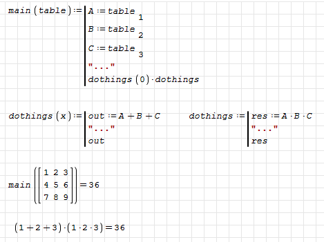

If in your worksheet you have to input the table once, move the data grouping outside the function on the canvas and everything will be available for any function.
However anything defined at some point is available at the same level and on deeper levels, thus you can make all more compact/readable by calling one or more functions after defining you data.

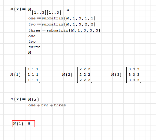

I believe you can do this, but you have to pass the function and their parameters in seperately. I do this for my Worst Case Analysis tool set I created which you can find here: https://en.smath.com/forum/yaf_postsm47624_Worst-Case-Analysis-Toolset.aspx#post47624
You do have to be careful of how you define the function and it's inputs, but it works. Attached is a simple example as well using pythagorean theorem. Файл не найден.Файл не найден.
