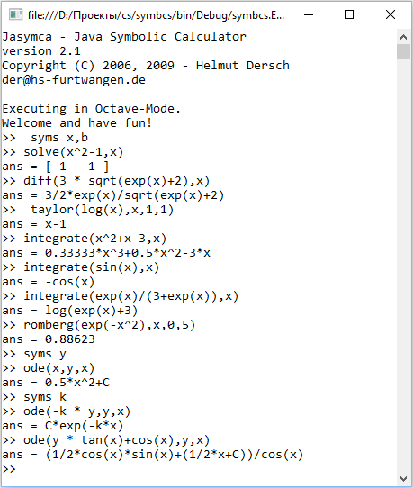

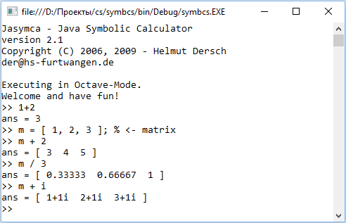

Simple calculations now work.
Alvaro 2/8/2019 3:18:00 PM
#8 Posted: 2/8/2019 7:05:16 PM
1,558 likes in 1,868 posts.
More functions.

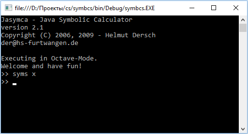

#10 Posted: 2/9/2019 9:10:38 AM
Binaries added to the repository.
exit + [ENTER] or [Ctrl] + [c] - Exit.
Alvaro 2/9/2019 12:58:00 PM
