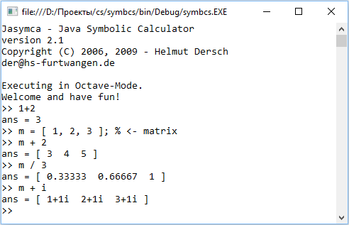

Simple calculations now work.

#8 Опубликовано: 08.02.2019 19:05:16

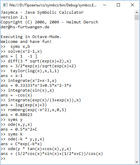

More functions.

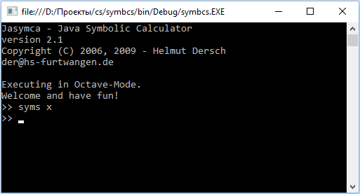

The program is partially restored. It is divided into two parts: the console and the library (Tiny.Science.dll).
This library was the goal of the project. Now its API needs to be brought into a convenient form.
