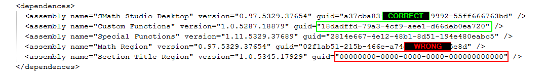

#44 Posted: 8/20/2014 5:14:54 AM
Seems that the file was saved using an old version of the plugin; meanwhile standards for plugins design was well defined, so a unique identifier (guid) was introduced for each plugin. It is easy to fix and you can do it by yourself.
Please open your worksheet with a text editor (Windows' Notepad, Notepad++, etc...)
Look at the headers of the XML code; you should see a block of code like this
<dependences>
      <assembly name="SMath Studio Desktop" version="..." guid="a37cba83-b69c-4c71-9992-55ff666763bd" />
      <assembly name="..." ... />
    </dependences>
Also, you should see that the plugin has saved a null Guid
<assembly name="Custom Functions" version="..." guid="00000000-0000-0000-0000-000000000000" />
To solve the issue, replace the null guid of Custom Functions with the official guid
18dadffd-79a3-4cf9-aee1-d66deb0ea720
Let me know if this solve your issues

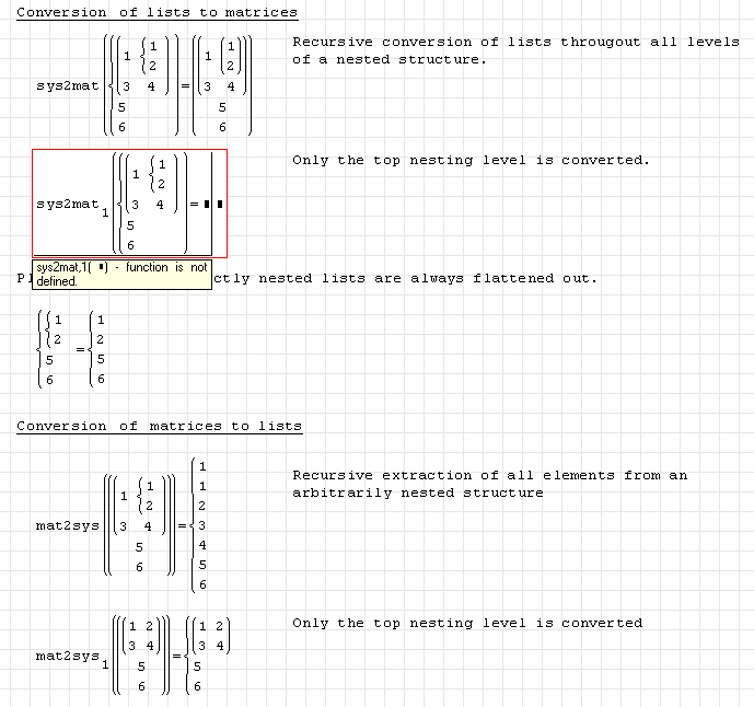

Has sys2mat.1() been withdrawn or is this a bug?
#48 Posted: 9/4/2014 8:25:42 AM
ops...
I've lost the sources of that update, not uploaded in the SVN, so I've rebuilt the missing functions but seems that I've forget the function. I'll restore it on the next update. :d

#51 Posted: 9/22/2015 4:02:09 AM
1,364 likes in 2,281 posts.
sys2mat.1() again seems to be missing...
sys2mat.1.sm (4.89 KiB) downloaded 1660 time(s).

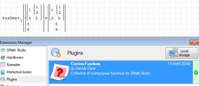

#52 Posted: 9/22/2015 5:11:36 AM
works for me... what version of the plugin do you have?
#53 Posted: 9/22/2015 5:51:39 AM
seems to be up to date.
EDIT: The function is avaiable, but obviously there have been changes in handling text indices. I choose sys2mat.1() from the dynamic assistant but the .1 won't display as text index. Once I delete the dot and type it in again, then the text index appears and the function becomes undefined.

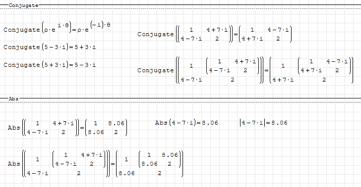

#56 Posted: 1/16/2016 12:40:38 PM
PLUGIN UPDATED SMath Studio 0.97.5346 and later and SMath Studio 0.97.5737
  • added Abs(1) (extends built-in abs(1) to matrices);
  • added Conjugate(1);
  • improved description of InterpBilinear(5);
  • refactoring;
2016-01-16 16_42_21-SMath Studio Desktop - [CustomFunctions_examples.sm].png
ioan92 1/16/2016 12:49:00 PM, sergio 1/16/2016 2:24:00 PM
#57 Posted: 1/19/2016 12:51:21 PM
Thank you Ioan, bug confirmed. I'll fix it ASAP.
ioan92 1/19/2016 2:42:00 PM
