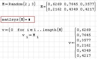

The mat2sys function seems to be limited to column matrices. This might be a feature rather than a bug. In the first case I would recommend to be more specific in the doc string ("Converts column matrices (vectors) to systems" ). Alternatively, the linear indexing feature could be used to flatten the matrix.
Radovan Omorjan 2/17/2013 7:59:00 AM
#24 Posted: 2/17/2013 2:45:16 PM
Hi Martin
Yes, actually mat2sys function is limited to column matrices (the function brutally changes "sys(" to "mat(", without checks).
An improvement will be available ASAP.

Martin Kraska 2/18/2013 5:58:00 AM
#25 Posted: 2/20/2013 11:56:19 AM
PLUGIN UPDATED
- mat2sys() now can handle also non-column matrices (nested or not)

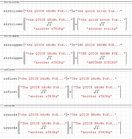

#26 Posted: 3/15/2013 7:05:31 AM
PLUGIN UPDATED
  • added new texts functions:
    • strtolower(1): converts all characters in a string to lowercase;
    • strtoupper(1): converts all characters in a string to uppercase;
    • ucfirst(1): converts the first characters in a string to uppercase;
    • ucwords(1): converts the first characters of each word in a string to uppercase;
    all functions works both with texts or texts nested in arrays/systems;

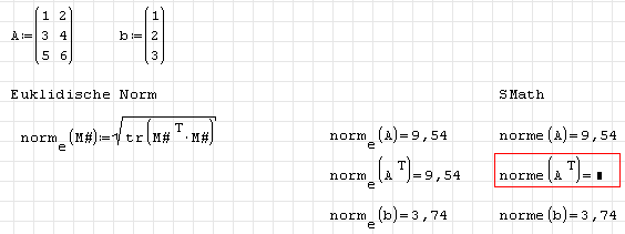

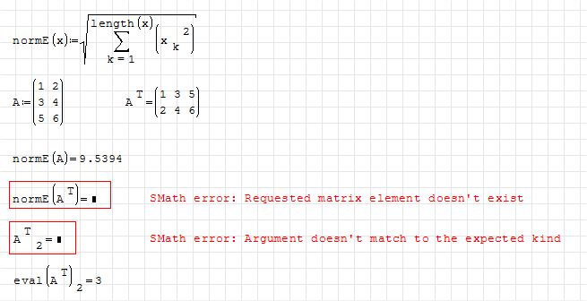

  • added norme(): unofficial patch of SMath Studio norme() function (BUG shown here);
  • sys2mat(): fixed unexpected influence on input arguments.

#27 Posted: 3/16/2013 3:59:58 PM
1,364 likes in 2,281 posts.
Hi Davide,
thanks for the update. I added the functions to the function reference in the handbook and also added a section on string functions.
The norme replacement is highly welcome. I just had a small problem, see attachment.
Just in case you are looking for distraction from real stuff like unit and systems proof solvers:
I'd vote for unit-proof versions of int(), Re() and Im() and arg().
Martin
#28 Posted: 3/16/2013 4:17:55 PM
Thank you Martin;
the issue is related with some SMath bug involving transpose and the linear indexing feature ... Tomorrow I'll look in the bug section to see if it has already been reported and I'll update the plugin with your formula

#29 Posted: 3/17/2013 7:40:20 AM
PLUGIN UPDATED
- fixed norme() issue involving transpose and the linear indexing feature;

Would it be possible to change mat2sys such that it doesn't collapse nested matrices?
Please see attached

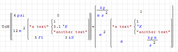

#33 Posted: 4/23/2013 4:31:11 AM
PLUGIN UPDATED
- fixed norme issue with 1x1 matrices
- UoM now get the units element-by-element from any matrix/system (nested or not)
best regards,
w3b5urf3r

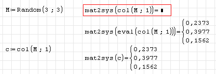

#36 Posted: 12/27/2013 9:29:52 AM
mat2sys requires the argument to be literal matrices. Matrix-valued expressions need to be evaluated first either by assigning them to a variable or by wrapping them in eval(). A similar issue has been reported for sys2mat and has been solved.
I propose to transfer the solution to mat2sys.
Davide Carpi 12/27/2013 8:24:00 PM

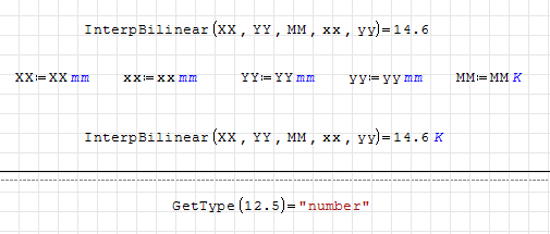

#37 Posted: 3/1/2014 12:12:08 PM
UPDATED
- new function: InterpBilinear()
- new function: GetType()
- mat2sys() improvements for 1x1 matrices
(examples attached in the first post)
2014-03-01 17_13_27-SMath Studio Desktop - [CustomFunctions_examples.sm_].png

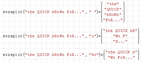

PLUGIN UPDATED
- added strsplit("string","delimiter" )
Best regards,
Davide
ioan92 6/23/2014 6:21:00 AM

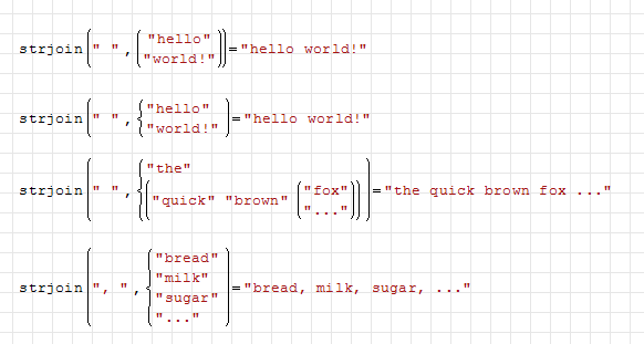

Davide, try string.Join().
Davide Carpi 6/23/2014 4:57:00 AM
#40 Posted: 6/23/2014 5:37:48 AM
Thank you Viacheslav
Done: added strjoin(2)
