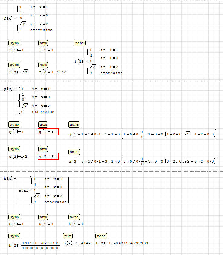

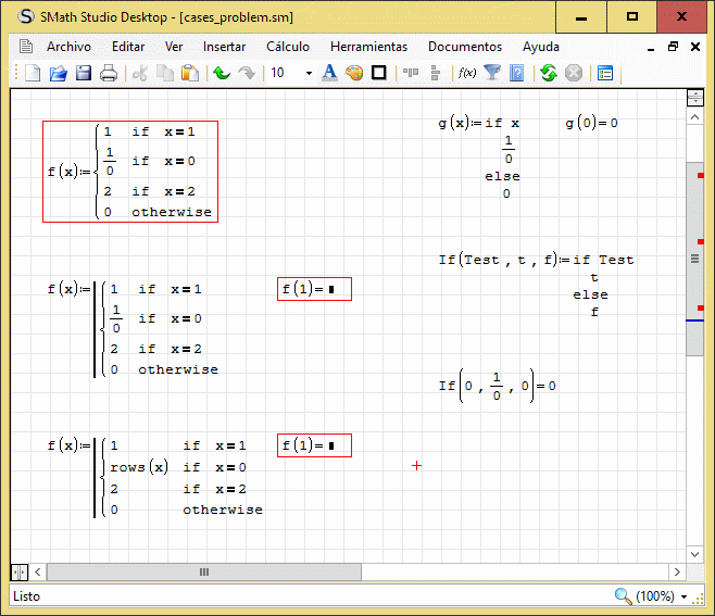

#68 Posted: 5/29/2016 9:31:12 PM
1,139 likes in 1,805 posts.
Hi. I guess that args for cases must to be unevaluated, like those if statements above. That's not only for errors, also for improve the speed of cases, which seems to eval all options before give the answer.
#69 Posted: 5/29/2016 10:25:49 PM
Mike Kaganski
Mike Kaganski
184 likes in 434 posts.
I suppose you may want to vote for SS-2316.
С уважением, Михаил Каганский

#73 Posted: 5/30/2016 5:01:52 AM
The function at() seems to have a problem similar to those observed in the maxima plugin.
Thank you Martin, I'll work on it ASAP.
As mentioned by Mike, this is addressed under SS-2316. As for now to evaluate only the function for the target condition you have to use eval() inside functions or numerical optimization outside functions.
I can't reproduce the first error shown in your picture, what plugin version are you running and in what SMath Studio?
#74 Posted: 5/30/2016 7:05:53 PM
Hi Davide. In the attached, with background are all errors "division by zero" cases_error.sm (98.13 KiB) downloaded 1654 time(s).in version 0.98 b5935 (last stable build, as I understand). Plugin version 1.1.5947.155599
#75 Posted: 5/31/2016 4:51:10 AM
Thank you, I can reproduce. This is before the SS-2318 implementation. In this case, you have to switch the optimization to numeric (symbolic uses the boolean sum and SMath ignores that x is a function's argument). If the function is behind a line, you have to wrap it in a eval().
