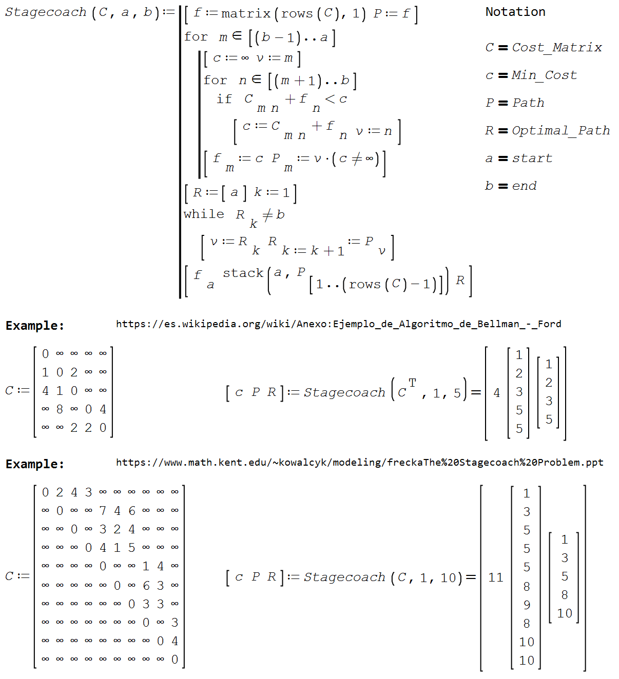

#4 Posted: 9/24/2026 2:28:21 AM
1,138 likes in 1,805 posts.
Hi. You can start with this.
Stagecoach Problem.sm (19.57 KiB) downloaded 238 time(s).
Edited 9/24/2026 3:01:59 AM
