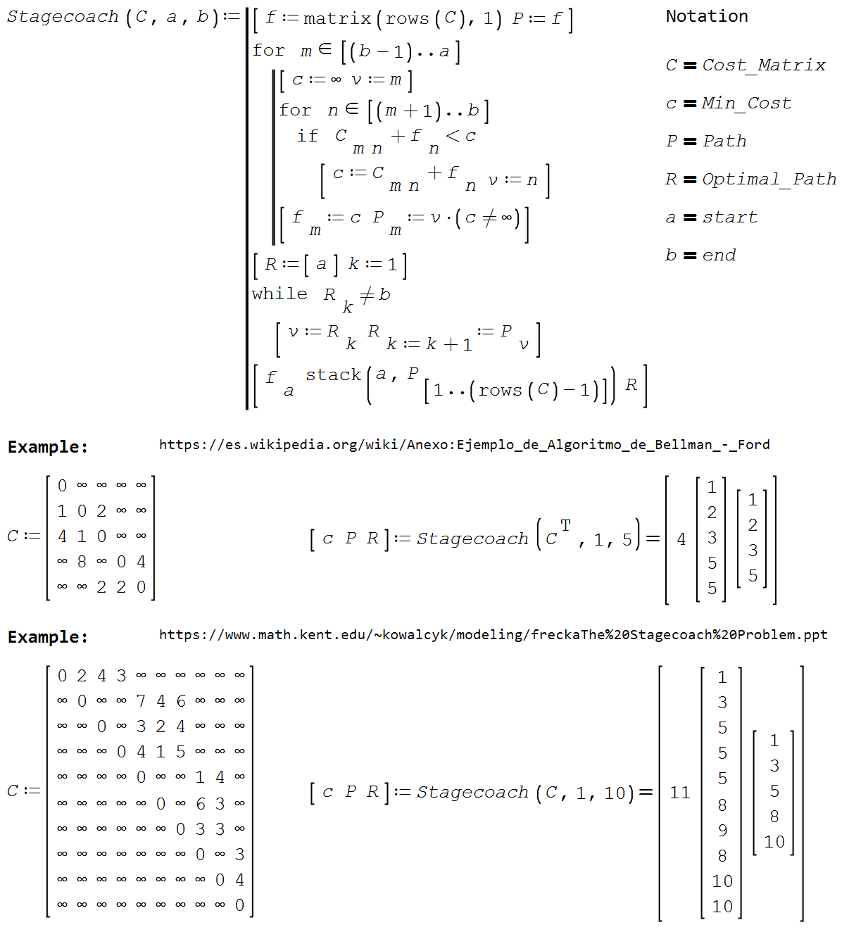

Hi. You can start with this.
Stagecoach Problem.sm (19,57 КиБ) скачан 98 раз(а).
