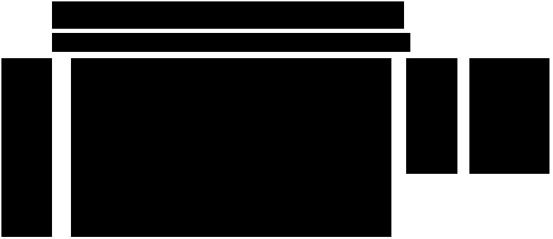

#5 Posted: 12/7/2021 12:01:36 PM
The Question: Is there a Dark Mode and if where do I click to get it?
Is that what you mean by Dark Mode ?
#6 Posted: 12/7/2021 1:02:38 PM
1,554 likes in 1,864 posts.
sergio 12/7/2021 1:22:00 PM, Davide Carpi 12/7/2021 3:00:00 PM
