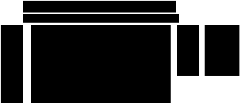

#5 Опубликовано: 07.12.2021 12:01:36
The Question: Is there a Dark Mode and if where do I click to get it?
Is that what you mean by Dark Mode ?
#6 Опубликовано: 07.12.2021 13:02:38
sergio 07.12.2021 13:22:00, Davide Carpi 07.12.2021 15:00:00
#7 Опубликовано: 07.12.2021 14:03:32
Sorry, I won't dare publish that f...n crap !
