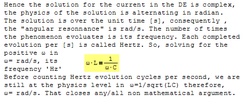

Try L[H], C[F] ... ωo=> Hz ... wrong... it should be rad/s

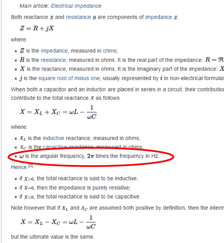

Wikipedia says:
https://en.wikipedia.org/wiki/Electrical_reactance

ωo => angular resonnance [rad/s]
You confuse yourself jumping from Wiki to Wiki
The angular Smath [Hz] unit error was reported before
[From recollection, reported by Mike].
Wikipedia is often useful, but by far not bible,
I would say "Indian telephone plagia from uneducated".
Take care Basile: Jean

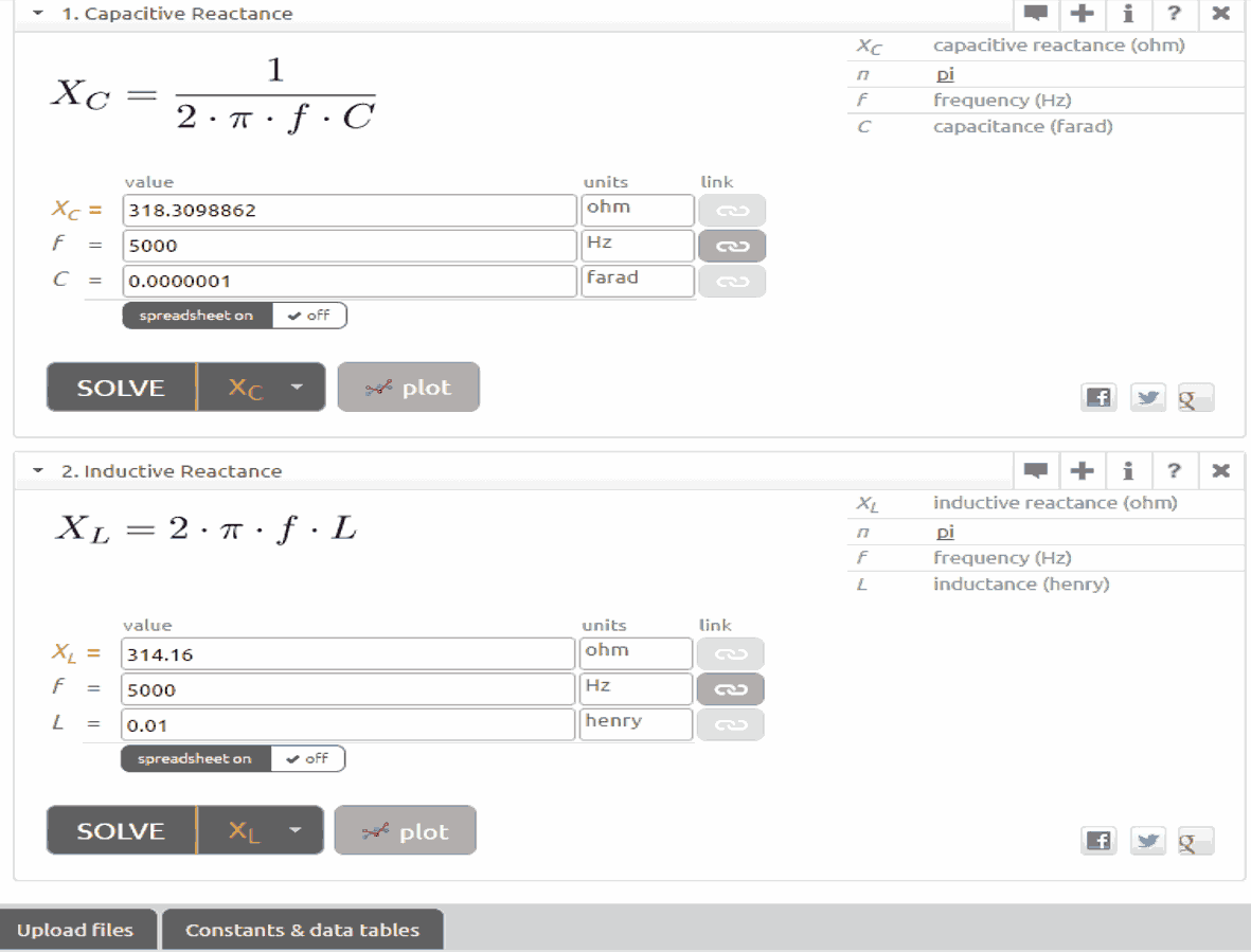

I 'm not confused , you could use the units Hz . in the frequency variable .
online calculator : http://www.fxsolver.com/solve/
#25 Posted: 6/28/2016 7:59:25 PM
You are right: Hz is the counts/second of the evolution.
But that is not the analysis of the physics.
