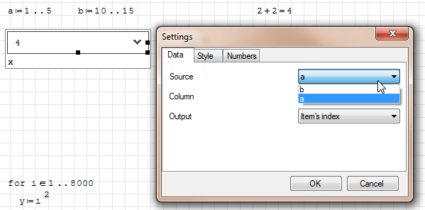

#5 Posted: 8/6/2014 5:34:45 AM
1,361 likes in 2,275 posts.
As stated in this post, I do not experience the problems reported SMath 0.97.5329 download topic. The attached files all run without problems and I can access all controls without crash.
Plugin Slider Region.sm (15.26 KiB) downloaded 1907 time(s).
Davide Carpi 8/6/2014 6:17:00 AM
#6 Posted: 8/6/2014 5:48:27 AM
Thank you Martin
I don't know where is the difference (on my machine the error shown in the previous screenshot was made yesterday on the desktiop distribution and today with your portable distribution - both with the second-last version of the plugin)
Just to have a complete debug, you can see the dynamic preview when you change the input variable from the ComboBoxList region? I have issues both with the last and the second-last plugins.
Thanks in advance,
Davide

#8 Posted: 8/6/2014 6:15:24 AM
I mean changing the value of the "Source" parameter in the form

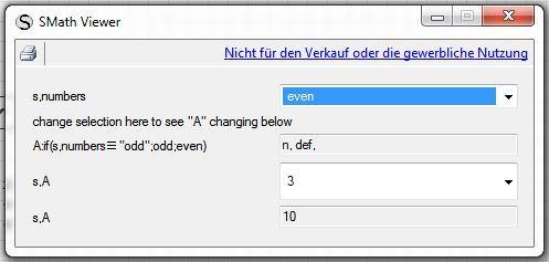

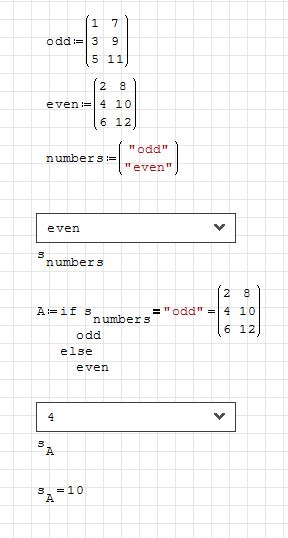

#19 Posted: 3/8/2016 8:28:39 PM
Eckhard Bräuchler
Eckhard Bräuchler
0 likes in 2 posts.
hello guys!
dear Davide Carpi,
as I've been using your very util plugin during
my tesis for the calculation of wooden joints,
I found out about a problem concerning the combined
use along with the Viewer.
It seems to me the once the Viewer loaded the file, all
the settings about the input variables for the comboboxList
are made. In the case, like you see in the example-pictures,
of multiple lists depending on their selection to decide
about the next-ones input, it comes to dificulties concerning
the update process.
The problem still consists with the newest version of SMath.
Is there a way to fix this problem?
I'd be glad aboud any advice of solution!
Thanks a lot!
Greetings,
Eckhard Bräuchler
