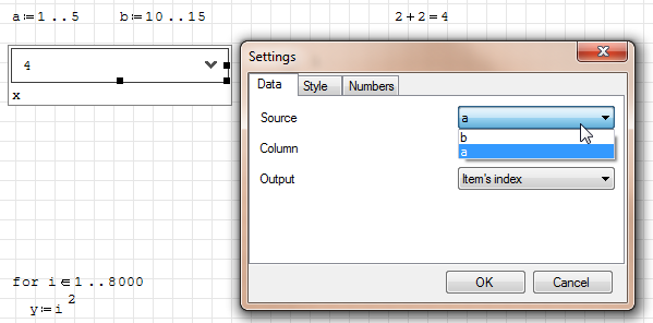

I mean changing the value of the "Source" parameter in the form
#9 Опубликовано: 06.08.2014 06:36:19
I defined another matrix d, switched the input to it and don't see any problem.
Davide Carpi 06.08.2014 07:44:00

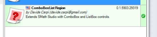

#18 Опубликовано: 13.02.2016 10:25:47
PLUGIN UPDATED SMath Studio 0.97.5346 and SMath Studio 0.97.5737
- Added Undo/Redo support;
- Plugins compiled for both the SS versions (no more crashes in SMath Studio 0.97.5346)

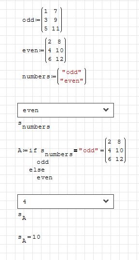

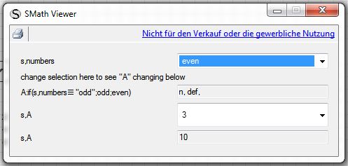

hello guys!
dear Davide Carpi,
as I've been using your very util plugin during
my tesis for the calculation of wooden joints,
I found out about a problem concerning the combined
use along with the Viewer.
It seems to me the once the Viewer loaded the file, all
the settings about the input variables for the comboboxList
are made. In the case, like you see in the example-pictures,
of multiple lists depending on their selection to decide
about the next-ones input, it comes to dificulties concerning
the update process.
The problem still consists with the newest version of SMath.
Is there a way to fix this problem?
I'd be glad aboud any advice of solution!
Thanks a lot!
Greetings,
Eckhard Bräuchler
#20 Опубликовано: 09.03.2016 07:57:22
Confirmed, I'll provide a fix ASAP.
