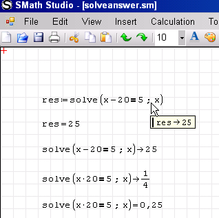

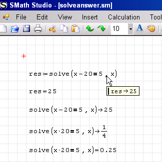

    #6 Posted: 7/2/2009 5:34:39 PM
    There is a problem with different Regional Settings. If you have Russian Regional settings you will have to use
    -comma "," for the decimal separator (Although in the Arithmetic palete the tooltip will say "Decimal point" )
    -semicolumn ";" for the argument separator
    For instance
    [MATH]res←solve(x-20≡5;x)[/MATH]
    [MATH]res=25[/MATH]
    [MATH]solve(x*20≡5;x)—1/4[/MATH]
    [MATH]solve(x*20≡5;x)=0,25[/MATH]
    If you use the English Reginal settings you will have to use
    -point "." for the decimal separator
    -comma "," for the argument separator
    (Can not be displayed here with "MATH" BBcode tag)
    Please take a look at the Arithmetic palete or your Reginal Settings. I do not know what yoy did, actually?

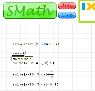

    By the way, both Reginal settings will solve your simple equation for me in Smath v0.8, but if I want to upload the file with these equation into "Live" SMath mode I've got the same error as you do: "No real roots" but only for the first (simple) equation. The other two "solve" will give the correct result ???
    I've been told by the SMath author that some problems are to be resolved with this Settings and the "Live" mode.

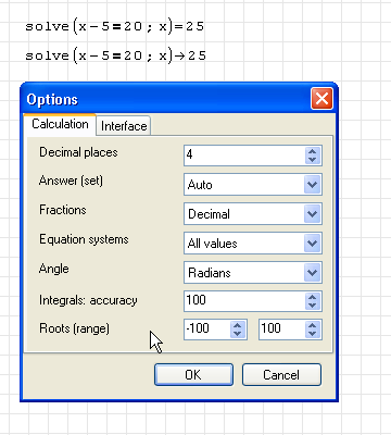

    #8 Posted: 7/3/2009 12:04:41 PM
    Have you checked the Roots(range) option?
    For instance, this will work
    but this will not (25 is outside the range[-20,20])
    By the way, Roots(range) might effect on the results, especially when there are more than one result.
    It might be a problem where searching the roots of different equations. I suppose this would be changed in the next SMath version. On the other hand, it seems that solve is not a symbolical but only a numerical solver at the moment.
    #9 Posted: 7/3/2009 2:56:12 PM
    Smfan
    Smfan
    0 likes in 7 posts.
    Thanks very much,
    solve(x-20=5,x) SOLVED OK IF I SET THE OPTION-ROOT RANGE:-100 TO 100
    however, i found another BUG perhaps here:
    when i set -1000 to 1000, no any msg alert me
    but the result role back to: no real root
    i have tried many times, the root range seems like limited -100 to 100 HARDLY.
    #10 Posted: 7/3/2009 3:59:26 PM
    2,343 likes in 4,057 posts.
    Hello.
    It's absolutely true. Solve function includes a simple iteration mechanism.
    No. Iteration algorithm has hardcoded step (with ratio to the range - this means that number of steps - constant), that's why answer will be more accuracy if the range will be smaller. And if range will be tot big, then step can be just too big and it can simply jump across the roots.

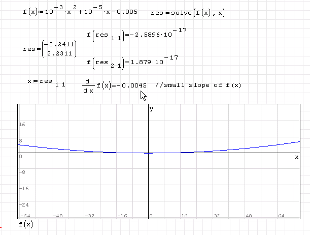

    As we know, the problematic equations for root finding could be the equations with small slope at the solutions. Here is a simple example.
    SMath solved that quite good (look at the error - order of magnitude 1e-17). But, the inconvenience could be if we try to locate the roots by plotting. I am not sure, but the scaling of the 2D plot could not be done separately on x and y axis. I think we can not locate the rots because of simultaneous scaling of both x and y axis. I spent some time trying (moving and scaling) to locate either one of the roots, but with no success. I do not know if I am right?

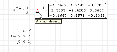

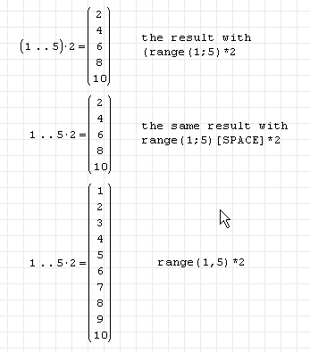

    I must be annoying but here are few of my findings. I do not think these are critical errors, but just to be for your attention.
    Please look at the image:
    I did the same as last time - moved the regions up. I expected to se empty placeholder at the numerical evaluation of the matrix inverse?
    This one I've already mentioned on the Private Massage. I hope I made myself understood about it. It might be just confusing and prone to errors.
    (I did see that I mixed ";" and "," as argument separators - it is Ok, just a typo in the text)

    #19 Posted: 7/6/2009 11:36:29 AM
    Thanks.
    First one is rather serious, will fix. It's really hard to make 0.82 release, too many complex code changes...
    I wish you all the best in your vacation.
