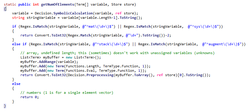

EDIT: If you are writing a plugin you can use something like the getNumOfElements function in StatisticalTools or NonlinearSolvers plugins

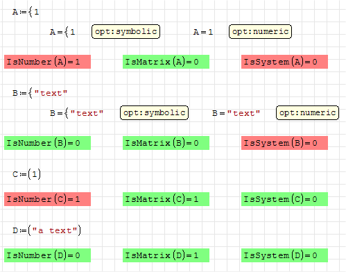

Just as a feedback the IsNumber fails evaluating infinity and imaginary unit and there are some issues with single elements arrays/systems

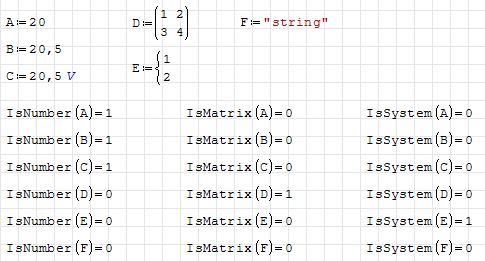

![SMath Studio - [Fbox_debug.sm]_2.png](/en-US/files/Download/EoTvT3/SMath-Studio---[Fbox_debug.sm]_2.png)

There still remain some other issues in your snippet (see the snapshot)

![SMath Studio - [whatIsFunction.sm].png](/en-US/files/Download/Fu687D/SMath-Studio---[whatIsFunction.sm].png)
You're correct about the error. I've fixed the sheet and have attached it below.
It'll work for everything i've tested it for, except strings with leading spaces " a".
