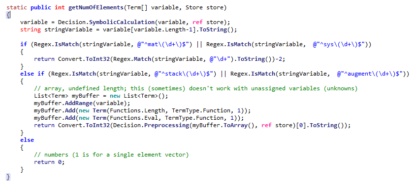

You can try to use/enhance the IsScalar() and IsMatrix() functions of varManager snippet (updated to fix an issue in IsArray(#)).
EDIT: If you are writing a plugin you can use something like the getNumOfElements function in StatisticalTools or NonlinearSolvers plugins

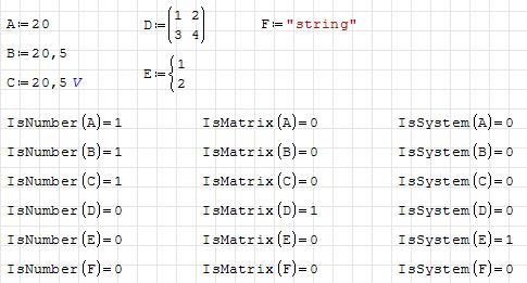

I started a new PlugIn Project called FunctionBox for SMath.
To bring it to life, I added the three requested functions
- IsMatrix
- IsSystem
- IsNumber
I did a lot of SMath plugin programming in the past and will contribute to the SMath project by providing some helpful plugins.
In the near future I will create a Wiki page for the FunctionBox where I describe the already available functions.
Also a post in this forum related to the plugin would be good to discuss new features.
So, find attached the FunctionBox.dll plugin and feel free to test it and provide feedback.
Have fun,
Infinity
I'm very glad that you came back with a new plugin
Just as a feedback the IsNumber fails evaluating infinity and imaginary unit and there are some issues with single elements arrays/systems
best regards,
w3b5urf3r

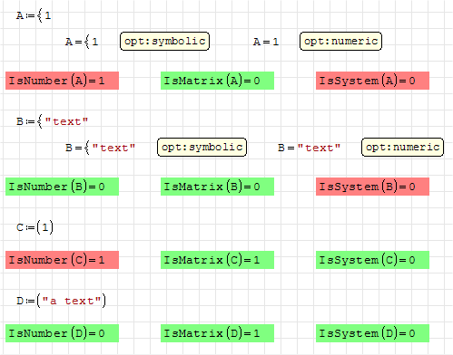

WroteUpdated the whatIs function to handle infinity and others. Checked to make sure correct output will be given regardless of optimization option. Corrected sheet is attached.
I also second the idea of creating a plugin forum.
Also, if we're going to create a database of plugins, and snippets, then i suggest we use couchdb as the database software to hold the code.
Good, also a snippet sub-forum it's not a bad idea!
There still remain some other issues in your snippet (see the snapshot)
regards,
w3b5urf3r
![SMath Studio - [whatIsFunction.sm].png](/ru-RU/files/Download/Fu687D/SMath-Studio---[whatIsFunction.sm].png)
You're correct about the error. I've fixed the sheet and have attached it below.
It'll work for everything i've tested it for, except strings with leading spaces " a".
Personally i don't like how the sheet is laid out. Duck typing the solution is a bad idea. As is the weird nested function solution, but i can't do a better solution until the num2str with spaces and other characters is fixed.
for now, it is highly recommended that you stick to A-z, 0-9, and _ until the bugs can be worked out.
