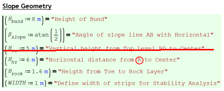

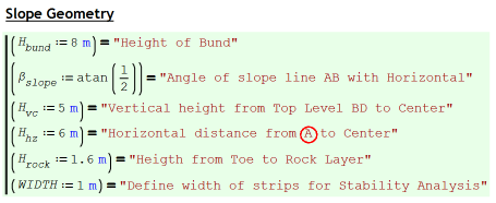

#5 Posted: 9/21/2023 7:45:50 AM
Please make the correction as shown ( replace A with -A in page 3).
Even without this correction, the program will run in most cases, but will give
wrong values for AA for some center cordinates.
This correction is an improvement.
Sorry for the inconvenience.
