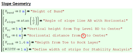

#2 Опубликовано: 16.09.2023 07:51:13
NDTM Amarasekera
NDTM Amarasekera
A small text correction to my post #1.
Sorry for inconvenience please.
Point A and Toe are also same.

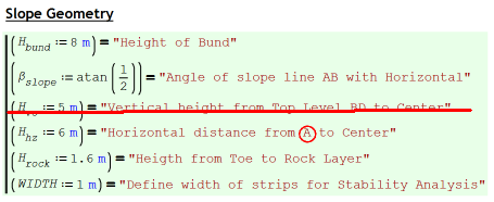

#3 Опубликовано: 16.09.2023 13:06:16
NDTM Amarasekera
NDTM Amarasekera
Second correction, as the variable Hvc is no longer used in the entire program. Please delete the entire line as indicated.
Extremely sorry.
