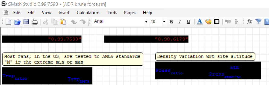

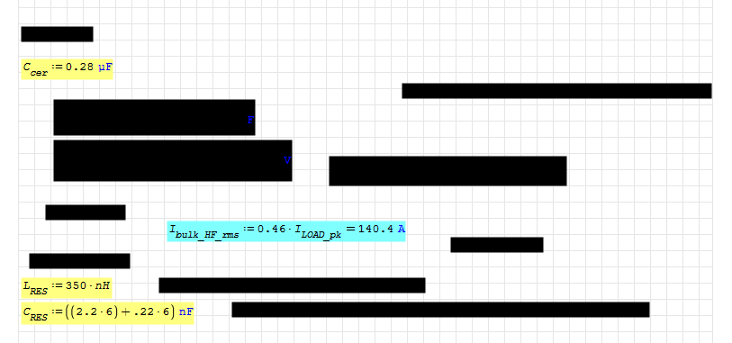

I'm working on the same file at home and at work. Today when I loaded it at work some lines' background turned black. This is version "0.99.7219.26345"
I've been playing with slightly different versions at home and work because of other bugs.
Has anyone seen this?

Problem is I have a bunch of expressions highlighted in various colors (e.g. user inputs, results), and they would get lost.

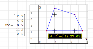

... download this recently created SS 6179.
What do you get in your recent SS 7219, all black ?
Maths Polygon Area_Perimeter.sm (55.37 KiB) downloaded 1571 time(s).

Yes, because I created this way [yellow maths on black background].
BTW: black is not [0,0,0] rather [1,1,1].

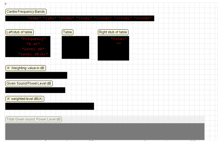

I have the same issue (0.99.7251.32800) with the acoustic file on https://en.smath.com/forum/yaf_postsm59725_Summation-of-log-functions.aspx#post59725

Bug is still present in Jean's file. Funny thing is this was MY work. His items came were hit or miss. I'm working off of portable version. See file post #3
#15 Posted: 1/11/2021 1:24:51 PM
The bug is solved since the transparent background is no more saved as black, but existing files are still affected because the background color was saved as black (#000000).
Because it is a legit operation to set the background as black it might be excessive to force it as transparent by the program; IMO the fix should be done manually (if you think there are a lot of file affected and is safe to bruteforce replace the backgrounds, a batch script can do the job easily)
