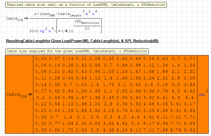

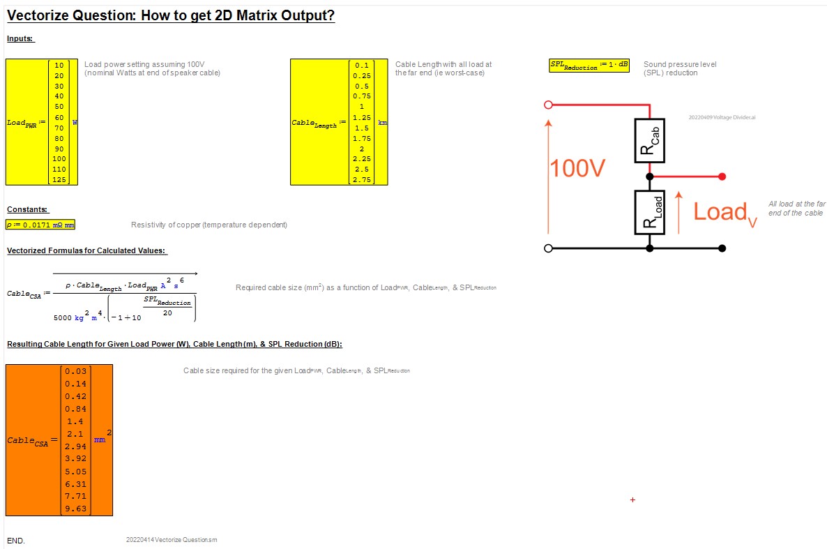

I've another noobie question. I'm hoping to get a 2D matrix/table output for two 1D vector inputs.
20220414 Vectorize Question.sm (52.61 KiB) downloaded 1285 time(s).
How can this be best done?

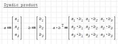

It can be done by dyadic product or piecewise algorithm calculation.
Notice the transpose symbol in your formula. Needed if both vectors are vertical or horizontal.
I have included both calculations, disabled algorithm calculation in collapsed area.

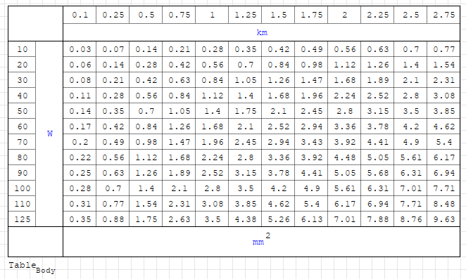

And since you asked, I have formatted the output with table region.
Check the file and pictures below.
Edit: I screwed up the product and table, corrected it now.
20220414 Vectorize Question_answer.sm (89.8 KiB) downloaded 1360 time(s).

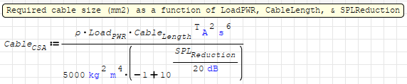

It is your choice. I have corrected the calculation.
It could be done by this way though, with using SI units.

Actually, your formula can be reduced to this.
Power of SI units. (swh)
Mark R Harris 4/14/2022 6:15:00 AM

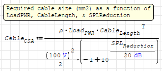

Your sample assumes 100V input according to picture.
For that, number of 5000 bothered me and maybe my assumption is wrong.
Is this a possible correct formula with voltage input added?
100V can be changed with a variable by this way.
#9 Posted: 4/14/2022 4:33:31 PM
Yes, 100V is the standard distribution level pretty much everywhere outside the US of A.
There it is 70V.
It should indeed be variable or constant.

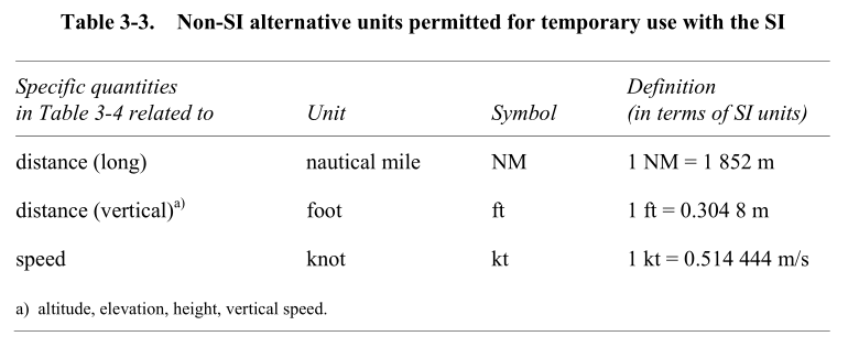

I understand nautical knot
The world standard for aircraft speed is SI units:
with knots operating on a 'temporary' exemption.
Two units with the same name, but different meanings are being used by people that need to work together. Ditto for different units for the same thing (height, wind speed, pressure, fuel mass, COG mass calcs, etc). What could possibly go wrong?

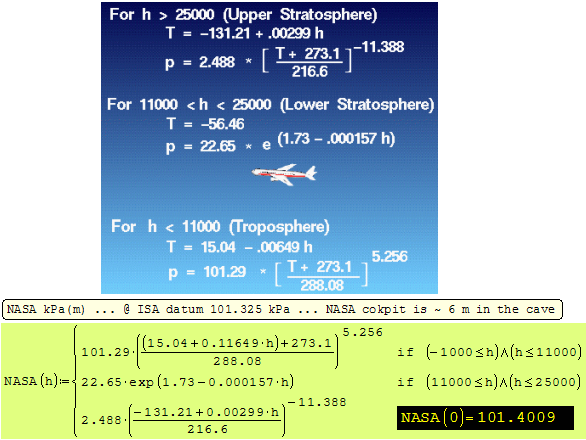

#14 Posted: 4/18/2022 8:25:51 AM
... What could possibly go wrong ? More, like cockpit calibration.
#15 Posted: 4/18/2022 10:19:56 AM
600 likes in 1,381 posts.
If you don't know units, how to use them, don't have the capability to understand its importance, even you oppose using units, just as like Jean, everything can go wrong.
And yours is another milestone example of that idiocracy.
#16 Posted: 4/18/2022 1:22:45 PM
1,139 likes in 1,805 posts.
Most. To begin it is a wrong sign in "15.04+0.11649*h", so it should be "15.04-0.11649*h"
In addition, this resource is not for technical use, it is for "K-12", which in the USA means that it is for elementary and high school children. The image page can be found here:
https://www.grc.nasa.gov/www/k-12/airplane/atmosmet.html
At the bottom in the complete image it can be seen how the author does not care in the least to follow the SI standards of units, using notations as varied and meaningless as "K-Pa" and "cu m"
Finally, if one consults the front page of the project, that is
can be read
"Glenn Learning Technologies Project (LTP)
In 2004 the Glenn LTP was no longer funded."
That is, that project has not been updated for almost two decades.
