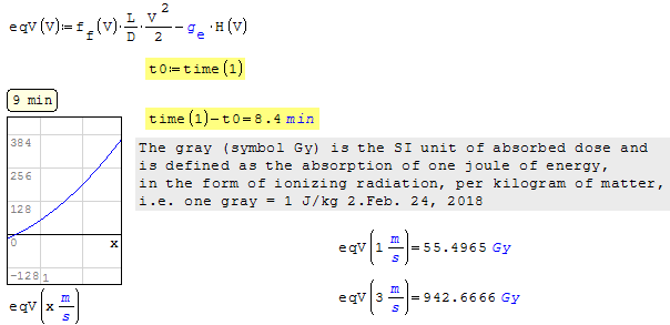

#4 Posted: 10/3/2021 8:42:55 PM
Liquid Flow Through a Pump Brute Force Plot.sm (56.99 KiB) downloaded 1330 time(s).
