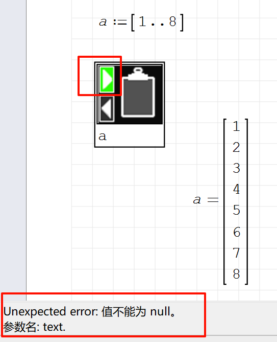

hi Davide
glad to find this extension ,but it seems dont work when export value
for export variable value , click Right-pointing triangle then it comes to an error , nothing copied to clipboard
for import value to variable , click left-pointing triangle then it works as expect
I'm not sure if the problem is on my end or with the plugin.
#22 Posted: 12/9/2025 6:13:52 PM
Hello, I'll check it, at first glance seems an error plugin-side.

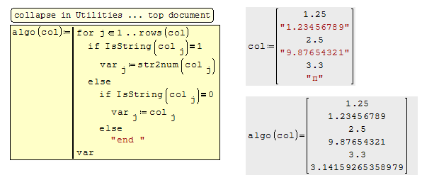

This is honestly such a lifesaver for moving data between SMath and Excel. Even with the occasional formatting quirks with negative values or scientific notation, it’s much faster than manual entry. I've found that using a quick 'str2num' or 'strrep' usually clears up those string issues in a pinch.
#24 Posted: 4/27/2026 11:27:38 AM
hi Davide
Found the issue, fixed code uploaded in the SVN. Can't release the plugin because (I think) there is an issue server side on the relase manager.
Dear David,
The finding was caused by new project format. Andrey performed necessary adjustments. You may finish your work now.
Gleb

#26 Posted: 4/28/2026 1:59:58 PM
Thank you very much!
Plugin updated
