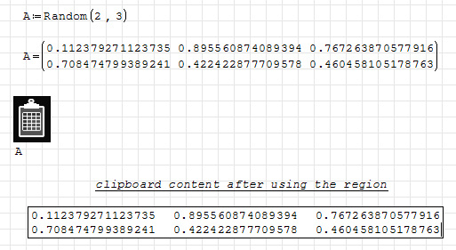

#1 Posted: 9/26/2013 8:32:23 PM
SMath up to 0.96.4909 > password: test
SMath 0.97.5301 or later >
link a variable in the placeholder and left-click on the region to export the variable to the clipboard (clipboard's content can be pasted in spreadsheets or text editors - can't be used as variable in SMath)
Also, you can paste spreadsheets data directly in the region placeholder.
PLEASE REPORT HERE ANY ISSUE
Best regards,
Davide

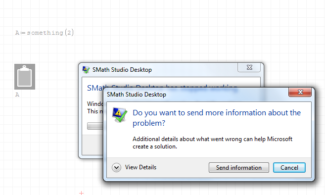

#3 Posted: 9/27/2013 12:13:04 PM
Thanks Davide
Try to reproduce this one
A:=something(2)
where something() is not defined. This will crash Smath for me.
Davide Carpi 9/28/2013 10:18:00 AM

#5 Posted: 9/28/2013 10:17:25 AM
Thanks Davide
A:=something(2)
fixed & updated

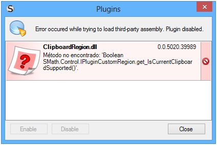

After installing the ClipboardRagion pluging Smath displays the error as follows.
I have neither the possibility of deleting nor re-installing.
Learning by doing
#8 Posted: 3/10/2014 3:59:22 AM
1,360 likes in 2,275 posts.
Just search for the dll and remove the associated folder structure, typically "some cryptic name/some version number". Currently that is the only way to remove plugins.
It may help to locate the settings directory using the function SettingsDirectory(). There you find folders extensions/plugins, where the above-mentioned plugin directories reside.
#9 Posted: 3/10/2014 4:24:30 AM
experimentator
experimentator
1 likes in 21 posts.
Danke Martin, it works, but I cannot install the extension again, occurs the same problem.

#10 Posted: 3/10/2014 4:45:58 AM
That's because the Clipboard Region plugin has not yet been updated to SMath Studio 0.97 (there were API changes). Also there might be problems in actually doing the update (Davide reported problems with clipboard handling).
Davide Carpi 3/10/2014 6:41:00 AM
#11 Posted: 3/10/2014 6:45:02 AM
Exactly, as for now this plugin works only with SMath up to 0.96.4909; a new plugin will be relased when Andrey will fix the issues in the clipboard interface.

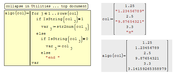

Hi all,
First of all, sorry for reopening such an old topic but.... hasn't anybody had an issue then trying to import to smath negative values from excel?
Maybe it's related with revision changes in both smath and excel, but when I have negative values I get them imported as text, between quotes "-0.534" i.e
any idea about how to solve that?
Thanks,

#16 Posted: 8/29/2022 3:01:06 PM
"-0.534" i.e
In the mean time it will doctored otherwise.

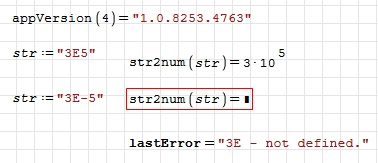

Hi Davide. Related, though not exactly a plugin question. But since you are going to see the question of the sign in strings, do you know how to specify a negative exponent inside SMath, as in the following example?
Thanks in advance.
sergio 8/29/2022 3:57:00 PM, churichuro 8/29/2022 8:02:00 PM

Alvaro an alternative way is
while a better solution is given.
sergio 8/30/2022 6:19:00 AM, Alvaro 8/30/2022 12:32:00 AM
#19 Posted: 8/30/2022 12:36:17 AM
1,138 likes in 1,805 posts.
Hi Churichurro. Thanks, it is a very good workaround, it works, substituting str2num(strrep(STR,"E-","*10^-" ) )
#20 Posted: 9/1/2022 9:25:12 AM
Reiltar
Reiltar
0 likes in 2 posts.
"-0.534" i.e
Thanks for this temporary solution.
