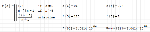

Is the recursion in SMath
Is the recursion in SMath - Messages
#1 Posted: 8/24/2024 12:02:53 PM
Valery Ochkov
Valery Ochkov
67 likes in 713 posts.
Factorial.sm (5.38 KiB) downloaded 1580 time(s).

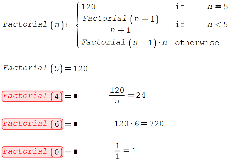

#2 Posted: 8/24/2024 2:10:48 PM
1,139 likes in 1,805 posts.
Hi Valery. Just use line:

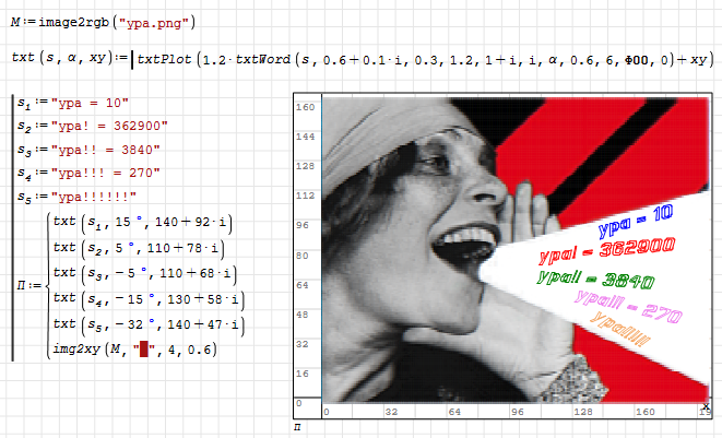

#6 Posted: 8/25/2024 5:36:18 PM
Hi. This other too.
img2xy ypa.pdf (423.85 KiB) downloaded 937 time(s).
img2xy ypa.sm (353.82 KiB) downloaded 1687 time(s).

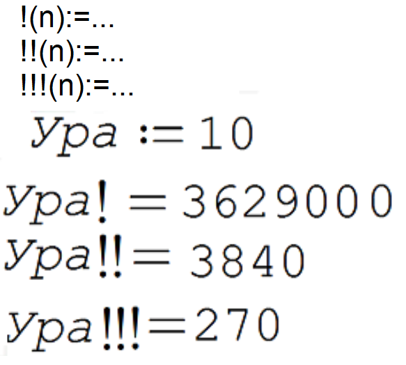

#7 Posted: 8/25/2024 6:18:38 PM
Valery Ochkov
Valery Ochkov
Thanks, Alvaro!
But I think about a postfix operator.
Alvaro 8/26/2024 7:20:00 PM

#9 Posted: 9/14/2024 11:37:49 PM
Valery Ochkov
Valery Ochkov
https://en.smath.com/forum/yaf_postst25358_Pre--Post--and-Infix-Operators.aspx
