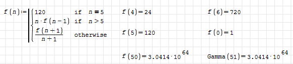

Hi Valery. Just use line:
Valery Ochkov 24.08.2024 14:15:00, sergio 25.08.2024 01:07:00

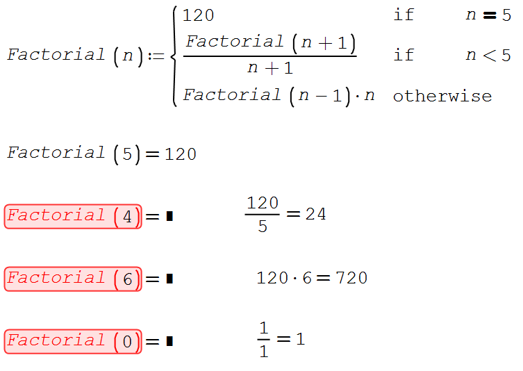

Create it in SMath!

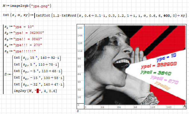

Hi. This other too.
img2xy ypa.pdf (423,85 КиБ) скачан 937 раз(а).
img2xy ypa.sm (353,82 КиБ) скачан 1687 раз(а).

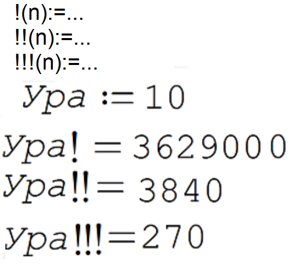

But I think about a postfix operator.

Oh. I see. What an epic fail trying to interpret an "it" (From "Create it in SMath! " ). I had seen that work at a Soviet art exhibition at the Museo de Bellas Artes in Mexico City, and it is without a doubt very representative of an entire movement.

https://en.smath.com/forum/yaf_postst25358_Pre--Post--and-Infix-Operators.aspx
