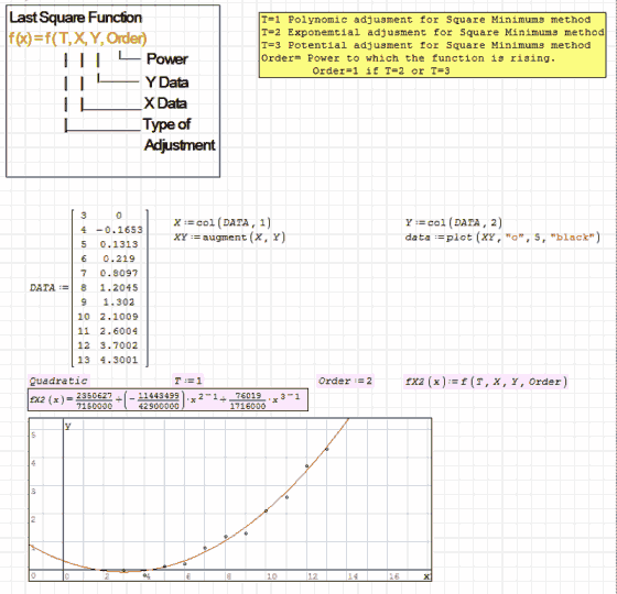

#1 Posted: 4/26/2019 12:06:13 AM
Another example of curve fitting by the least squares method
with option to select the power of the polynomial, or
select the adjustment of the curve to exponential or potential.
Ajust_by_Last_Square_Selection_Jean.sm (56.61 KiB) downloaded 1454 time(s).

#2 Posted: 4/26/2019 10:40:32 AM
WroteAnother example of curve fitting by the least squares method
Hola Carlos !
Couldn't open the attached SS 7030 work sheet.
It happened another time from maybe Alvaro ?
Seemingly caused by 2 of your modules not activated.
My SS 6179 does not closed those two particular modules.
However, I have recognized the flat parabola data set.
I'm sure your proposal will have more applications.

#3 Posted: 4/26/2019 2:18:39 PM
Hola Carlos !
Hola Jean
Here you have a version in 6179 of the work sheet
of the method of adjustment of curves by least squares
Ajust_by_Last_Square_Selection_Jean_V6179.sm (52.77 KiB) downloaded 1473 time(s).
Cheers
