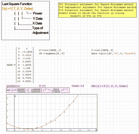

Another example of curve fitting by the least squares method
with option to select the power of the polynomial, or
select the adjustment of the curve to exponential or potential.
Ajust_by_Last_Square_Selection_Jean.sm (56,61 КиБ) скачан 1364 раз(а).
