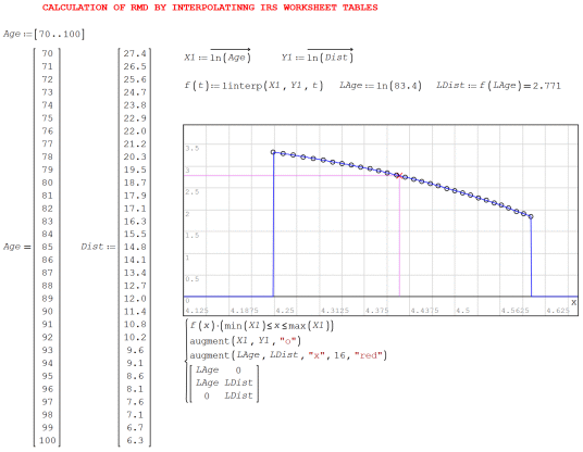

Sorry to be so slow on Smath. Some thing work like Mathcad and some don't. I need help with the correct syntax for the interpolation function linterp. I have tired all combinations of syntax that I can think of and none work in the attached Smath file.
Help would be appreciated.

I don't think vectorize works with this function. It is expecting a single value in argument 3. Checkout my linterp2 function in the attached. I think it does what you want.
RMD CALCULATION.sm (18.24 KiB) downloaded 1275 time(s).
Note: In my program, it is not necessary to initialize the result. However, I have found that in cases of large vectors, it speeds up processing time to initialize a vector to the expected size and then fill in values. I generally just do this as standard practice now even if it's not necessary.

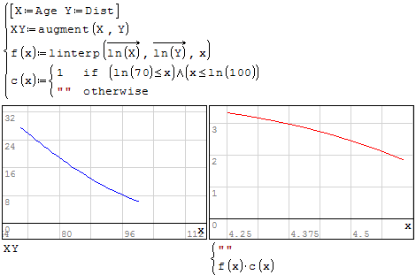

Hi. You can do some plots too.
RMD CALCULATION.sm (10.79 KiB) downloaded 1305 time(s).

Thanks to all. I was able to find some useful stuff from everyone. Here is where I was headed.
RMD CALCULATION.sm (16.94 KiB) downloaded 1223 time(s).

Pay attention to the plot by Alvaro. He uses often neded lele() function (Custom functions plugin) for checking if the value is in a range: Xmin<=x<=Xmax
frapuano 2/15/2019 5:52:00 AM

Is this XY plot new? I find it really helpful.
RMD CALCULATION.sm (18.33 KiB) downloaded 1231 time(s).
#18 Posted: 2/15/2019 10:48:25 PM
Is this XY plot new?I find it really helpful.
Not new, just from applied Smath features as in older SS 6179.
