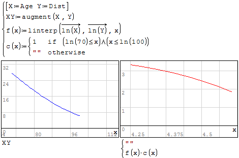

#8 Опубликовано: 14.02.2019 22:57:58
Oops I meant this way to no success.
RMD CALCULATION (J).sm (18,81 КиБ) скачан 1280 раз(а).
#9 Опубликовано: 14.02.2019 23:51:13
... a bit .
RMD CALCULATION (J).sm (26,09 КиБ) скачан 1289 раз(а).

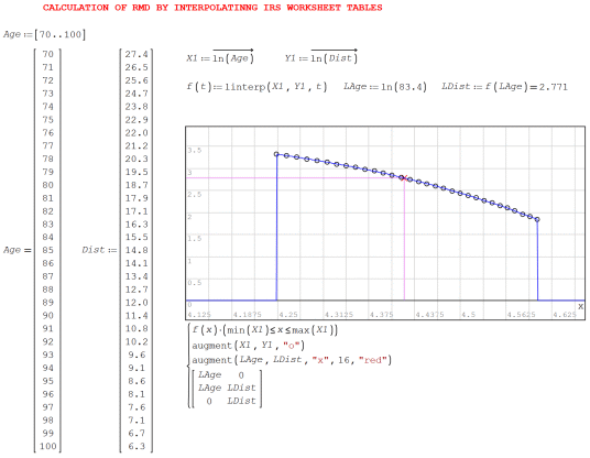

#12 Опубликовано: 15.02.2019 00:41:09
Hi. You can do some plots too.
RMD CALCULATION.sm (10,79 КиБ) скачан 1305 раз(а).

#15 Опубликовано: 15.02.2019 03:51:44
Just a note.
Pay attention to the plot by Alvaro. He uses often neded lele() function (Custom functions plugin) for checking if the value is in a range: Xmin<=x<=Xmax

#16 Опубликовано: 15.02.2019 12:47:44
Thanks to all.I was able to find some useful stuff from everyone.
... more in there for publishing.
Little Smath doing so much, so nice !
RMD CALCULATION (J).sm (35,64 КиБ) скачан 1278 раз(а).
