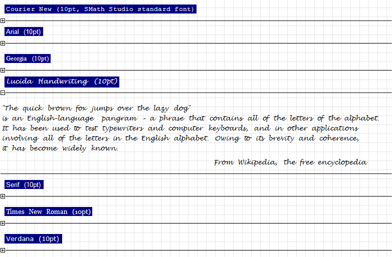

A sheet containing some text area with various font-families to use in your own scripts (copy from this sheet, paste in your sheets and modify the area).
best regards,
w3b5urf3r
Uploaded in the Extensions Manager (Examples)

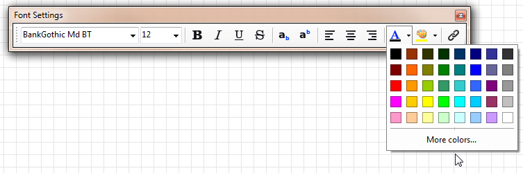

BTW working to the SectionRegions plugin, I'm making an easy-to-use WriterRegion, and I've also produced a (back-end) customizable toolstrip to drive the text settings (as for now, the toolbar is just a toy).
ioan92 9/26/2014 2:17:00 PM

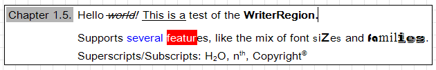

A screenshot... will be relased as WriterRegion (when will be stable and complete enough).
6 users liked this post
hitaisin 1/4/2015 4:37:00 AM, Radovan Omorjan 10/8/2014 1:54:00 PM, Вячеслав Мезенцев 10/8/2014 1:12:00 PM, ioan92 10/8/2014 3:28:00 PM, Peter 10/9/2014 12:07:00 AM, Andrey Ivashov 10/11/2014 9:11:00 AM

Any news about WriterRegion?
Can I change default font in application? I want to use Arial as default font.

Hello hitaisin
The plugin is still under development. I have to change an important piece of code to improve performances and to support text wrapping, and then I have to ask Andrey about History handling because the code doesn't work as expected. After this, the plugin will be published.
You can change the font family of text regions with another plugin (Text Region Utilities), but you can't set a default font to use everytimes.
