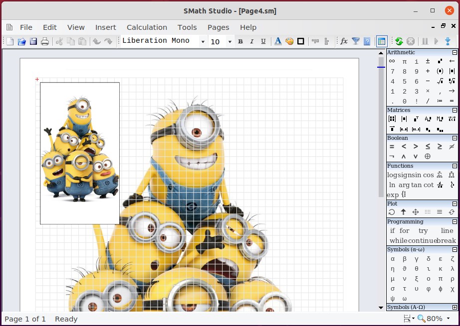

If your Insert > Picture > From File, function don't work properly on Linux.
When I add picture file it shows in SMath but when I save-close-reopen it disappears.
Region is there but picture is gone. In a text editor, base64 data is mostly missing too.
Most of image data is neglected and not written.
I have checked this with another user and another machine of mine.
Image Region don't have this issue.

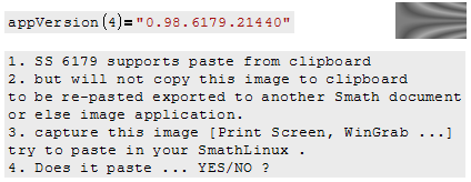

Let it go step by step, this first step
Can you in your latest SS copy few math regions and paste in IrfanView.
SS 6179 can't ... Mathcad 8, 11 can for unlimited number of regions ... pages.
If you haven't experimented Venturi as described, sorry but end of it.

Linux Picture Insert Bug Video
Somehow SMath is not getting full picture data, this is not Linux bug. This is a SMath bug on Linux.

Hi, it's working for me. Thanks!
#15 Posted: 10/23/2020 11:34:58 AM
601 likes in 1,382 posts.
All is good here, dragging picture from file managers works too.
Thank you Andrey for quick response.

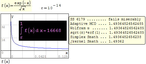

Not long ago, SS 7959 integration had to be doctored.
Please try that one for the benefit of the Community.
#17 Posted: 10/23/2020 12:15:49 PM

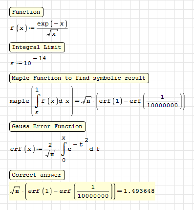

By the way, the calculation you have sent is a Gauss Error Function. erf()
Apparently SMath don't have it yet but you can implement it easily.
Maybe Andrey will add erf() someday, who knows.
I have calculated this on windows. Maple don't work on linux, yet.

#18 Posted: 10/23/2020 9:19:04 PM
Thanks for checking latest SS
Erf(x) is built-in since at least SS 5346 erf(1) from f(x) menu
erf(x) is a monkey business approximation [Mathematica]
But works well in Smath, presumably all versions.
Maths erf(x).sm (32.6 KiB) downloaded 1483 time(s).

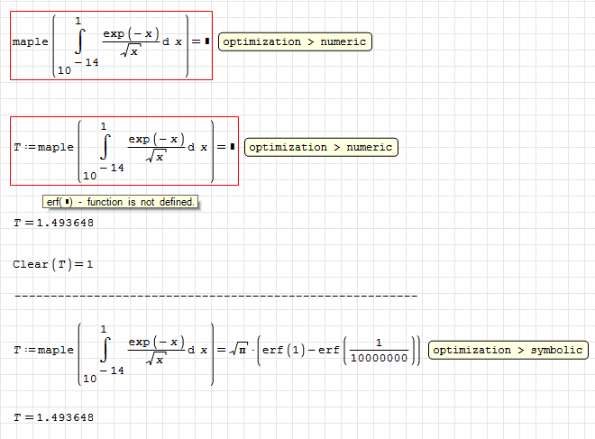

erf() is not built-in to SMath, I have checked.
It is a function of Statistical Tools plugin.
That plugin was not installed on my setup.
I have installed the Statistical Tools plugin to get erf().
It works but still gives "erf() function is not defined" error with maple.
Numeric optimization is causing this when I try to get a numeric result.
However it is calculating the expression and giving the result assigned to a variable, even with numeric optimization.
No issues with symbolic optimization I guess.
Odd behavior.
