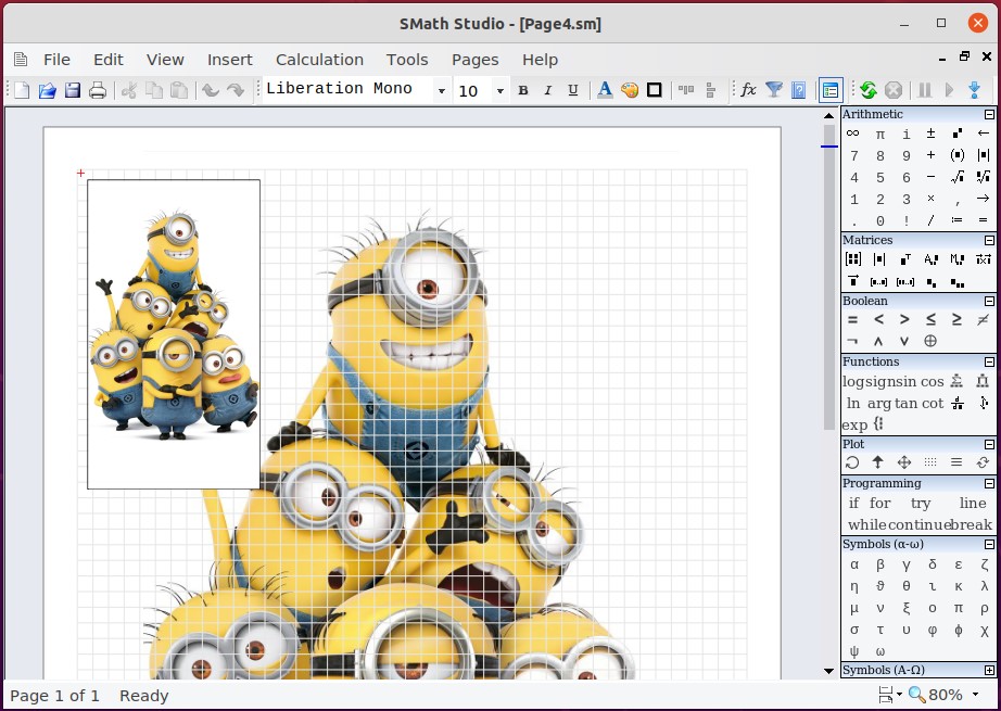

If your Insert > Picture > From File, function don't work properly on Linux.
When I add picture file it shows in SMath but when I save-close-reopen it disappears.
Region is there but picture is gone. In a text editor, base64 data is mostly missing too.
Most of image data is neglected and not written.
I have checked this with another user and another machine of mine.
Image Region don't have this issue.

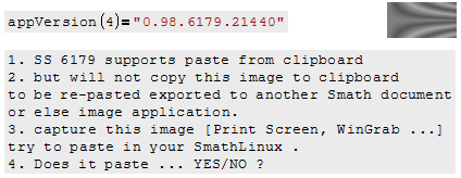

Long time ago, I mentioned Smath didn't support copy to clipboard
Was it SS 5346 or SS 6179 ?
Apparently it was fixed. Whatever, it has to be clear that the problem
is SmathLinux from Linux not supporting clipboard paste.
Thanks Jean, but that is not correct. This report is that inserting an image from a file on disk doesn't work in Linux. The clipboard issue is a different topic.

Let it go step by step, this first step
Can you in your latest SS copy few math regions and paste in IrfanView.
SS 6179 can't ... Mathcad 8, 11 can for unlimited number of regions ... pages.
If you haven't experimented Venturi as described, sorry but end of it.

Here let me demonstrate it with a video for you to explain it more detailed.
Linux Picture Insert Bug Video
Somehow SMath is not getting full picture data, this is not Linux bug. This is a SMath bug on Linux.

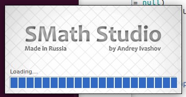

New test version prepared: http://smath.com/file/UMobd
  • Loading splash screen layout fixed:
  • Work with images fixed (save/open files with images, image regions copy/paste, background images)
  • Dark OS theme supported now (not all toolbox icons are vectorized yet - this is test version);
sergio 23.10.2020 06:52:00, Вячеслав Мезенцев 23.10.2020 09:48:00, overlord 23.10.2020 11:34:00

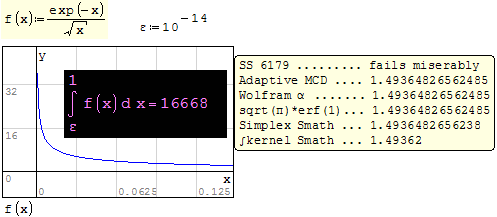

Just update your SMath to latest version for full features
Not long ago, SS 7959 integration had to be doctored.
Please try that one for the benefit of the Community.

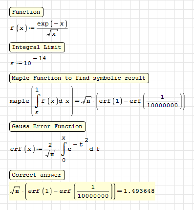

By the way, the calculation you have sent is a Gauss Error Function. erf()
Apparently SMath don't have it yet but you can implement it easily.
Maybe Andrey will add erf() someday, who knows.
I have calculated this on windows. Maple don't work on linux, yet.

Thanks for checking latest SS
Erf(x) is built-in since at least SS 5346 erf(1) from f(x) menu
erf(x) is a monkey business approximation [Mathematica]
But works well in Smath, presumably all versions.
Maths erf(x).sm (32,6 КиБ) скачан 1483 раз(а).

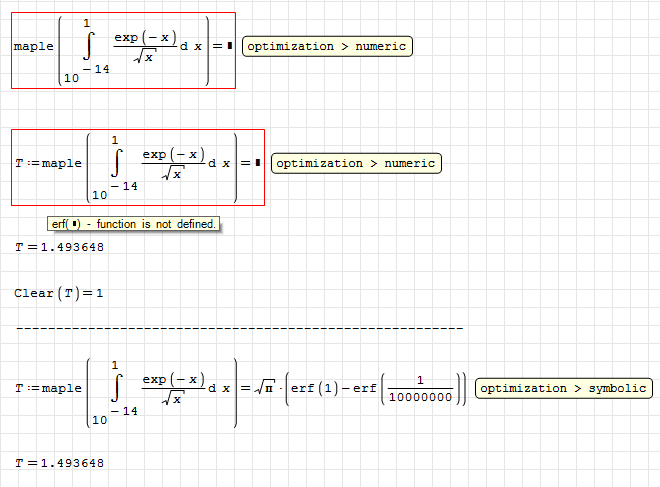

erf() is not built-in to SMath, I have checked.
It is a function of Statistical Tools plugin.
That plugin was not installed on my setup.
I have installed the Statistical Tools plugin to get erf().
It works but still gives "erf() function is not defined" error with maple.
Numeric optimization is causing this when I try to get a numeric result.
However it is calculating the expression and giving the result assigned to a variable, even with numeric optimization.
No issues with symbolic optimization I guess.
Odd behavior.
