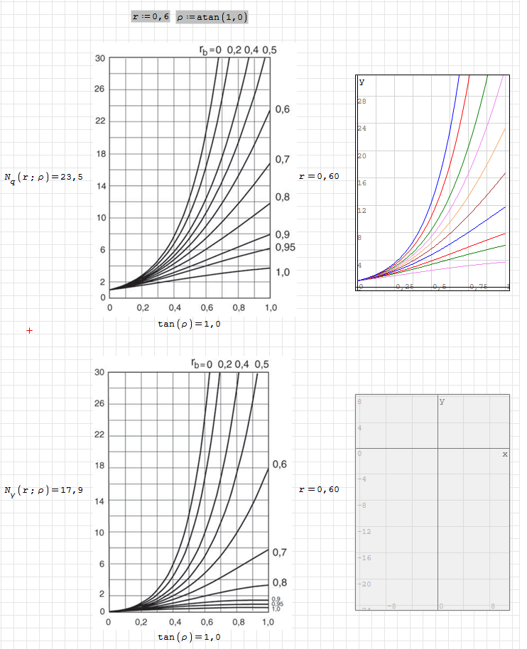

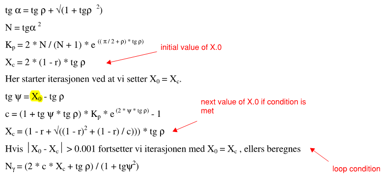

I need help with a iterative calculation. This is my first time trying to build a iterative loop in SMath.
I need to calculate a coefficient that can only be calculated when the difference between X.0 and X.c is below a limit.
I am trying to solve this as a function of r and rho.
Can someone help me get started on how to formulate the iteration?
problem.sm (11.9 KiB) downloaded 1131 time(s).
Best regards,

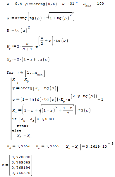

#2 Posted: 10/2/2020 2:47:52 PM
1,359 likes in 2,273 posts.
problem_Kr.sm (10.77 KiB) downloaded 1214 time(s).

#4 Posted: 10/2/2020 4:58:52 PM
Thank you for your suggestion Martin!
I need the output X to be a function of r and rho. Is that possible?
Some random questions...
1. why do you use arctg instead of atan?
2. does the iterative process have to be wrapped into a for loop where you need to give it a range, and ultimately an upper boundry (n.max)?
0. I think you would need to wrap the full procedure into a function of r and rho with X as return value. Alternatively, you might come up with a recursive definition of the procedure.
1. It is just the setting world versus european style for functions. It is the same function, just displayed according to the GUI settings.
2. the for loop just came in handy for generating the indices for storage of iteration history. You could use while 1 as well. I also thought it was a good idea to have an upper limit for the iterations in case the algorithm might diverge.

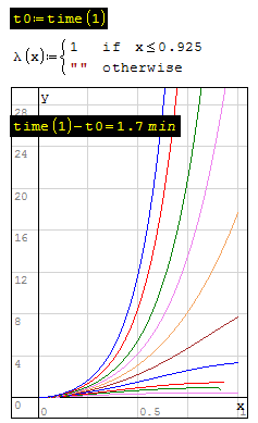

#12 Posted: 10/3/2020 2:40:12 PM
My oldere version would go on for minutes without being able to plot N.gamma.
My steam engine laptop SS 6179 runs Martin in 1.8 min.
It runs the solver 168*10= 1680 for all 10 plots
Set j=9 ... constrain gamma 0.9 reluctant
Set the solver in eval(,) mode.
problem_solved_Kr Sanity.sm (510.04 KiB) downloaded 1229 time(s).

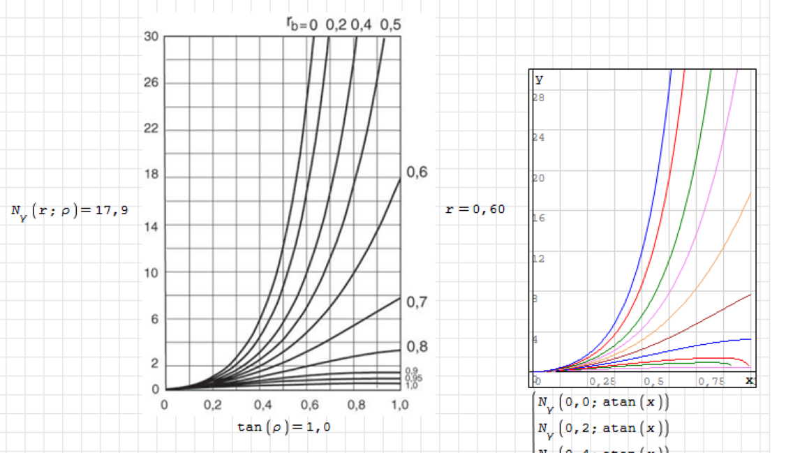

#20 Posted: 10/4/2020 1:51:31 PM
hanskl
hanskl
7 likes in 158 posts.
I have tinkered a bit because there seems to be a mismatch between my graph and the diagram for some values of r and rho.
The plots of N.γ(0.9,atan(x)) and N.γ(0.95,atan(x)) has an odd shape when they approach x=1. It turns out there are some complex solutions in this area.
Is there anything to be done about this, to make the graph closer resemble the diagram?
Cheers
