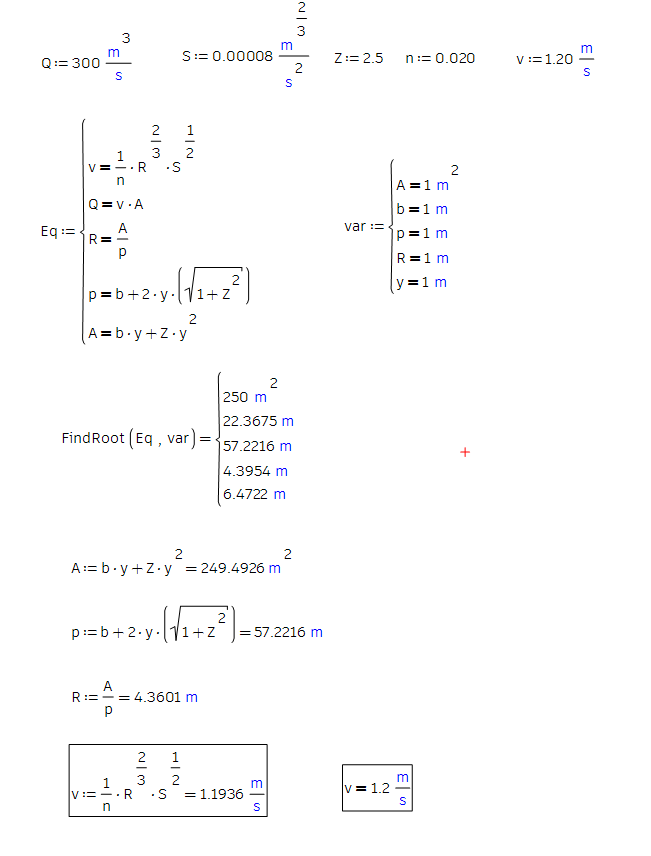

Hi, I want to know what is the method of enhance precision in numerical solution into plugin Nonlinear Solvers.
Precision.sm (12.95 KiB) downloaded 1141 time(s).
There is method unless some reference from source.
Some solvers work more accurately then others.
Generally, they will range from 4 decimals to 15 decimals.
Some functions are so involved in numerical error propagation
that you will have to refine the search range ... Goat radius.
Cheers ... Jean.
Precision.sm (20.77 KiB) downloaded 1150 time(s).

Yes, using a initial values more accurately I have a better precision. Thanks so much
