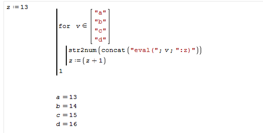

#2 Posted: 7/7/2023 5:06:15 AM
That's one of the other options.
Thanks, unfortunately value to be assigned is supposed to come from somewhere else, z was just an example because I didn't want to make example with large vectors or matrices to be assigned.
I was looking for a function that would turn a string into a variable that can be used as lhs operand in assignment.

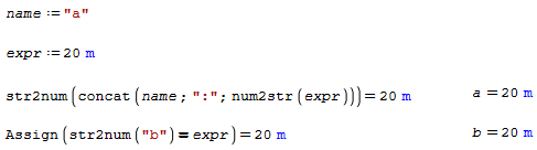

#4 Posted: 7/7/2023 8:02:53 PM
1,362 likes in 2,276 posts.
If the value to be assigned is an ordinary expression, then just convert it to a string before using the above-mentioned methods.
asg.sm (4.31 KiB) downloaded 1478 time(s).
