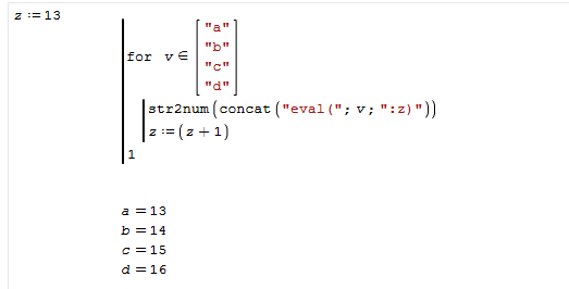

Is it possible to procedurally define variables from strings?
I want to load data to a lot of sets of variables with names following a pattern preferably without doing that manually.
Is there a better way than:
example.sm (4,39 КиБ) скачан 1450 раз(а).?

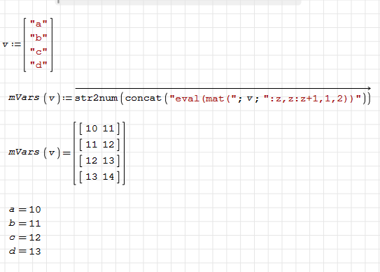

#2 Опубликовано: 07.07.2023 05:06:15
That's one of the other options.
#3 Опубликовано: 07.07.2023 16:18:37
Lupus the Canine
Lupus the Canine
0 сообщений из 7 понравились пользователям.
Thanks, unfortunately value to be assigned is supposed to come from somewhere else, z was just an example because I didn't want to make example with large vectors or matrices to be assigned.
I was looking for a function that would turn a string into a variable that can be used as lhs operand in assignment.

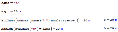

#4 Опубликовано: 07.07.2023 20:02:53
If the value to be assigned is an ordinary expression, then just convert it to a string before using the above-mentioned methods.
asg.sm (4,31 КиБ) скачан 1478 раз(а).
#5 Опубликовано: 07.07.2023 23:52:52
Something like this?
z can be anything and come from anywhere.
As long as it has same length with v.
StrAssign.sm (6,91 КиБ) скачан 1432 раз(а).
