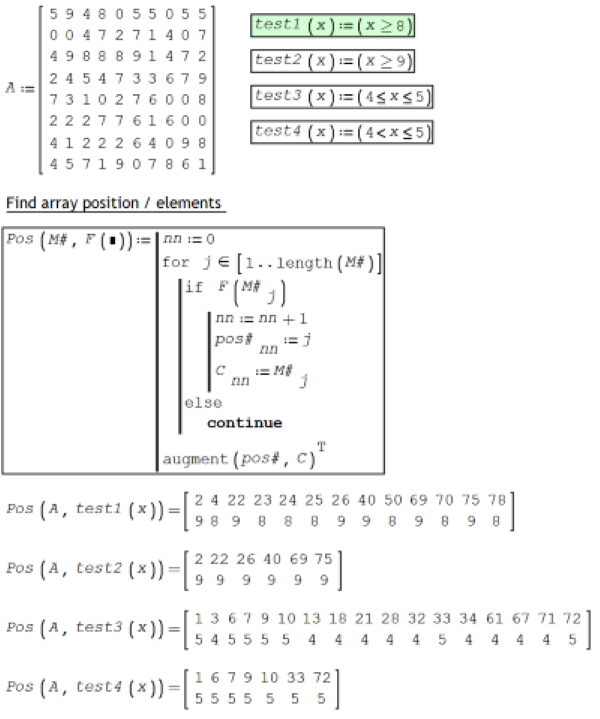

#5 Posted: 6/27/2023 12:13:11 PM
NDTM Amarasekera
NDTM Amarasekera
130 likes in 352 posts.
Another method
Array_Pos.sm (14.76 KiB) downloaded 1408 time(s).

Ndtma,
Thanks; however, I don’t understand the large numbers in your answer, which are greater than the size of the matrix.
Sorry for my lack of understanding.
Reg CurryLoveland, CO
#7 Posted: 6/27/2023 4:48:45 PM
Ndtma,
It's the item position by linear indexing. Elements can be accessed using a single index, that is the position sorted by rows (base 1). f.e. The 2nd element in the 3rd row is indexed (3-1)*cols(matrix)+2
