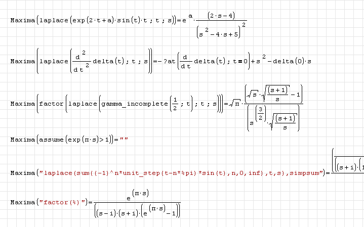

Try Maxima plugin
[MATH=eng]Maxima(assume(ω>0))=ω>0[/MATH]
[MATH=eng]Maxima(laplace(sin(ω*t),t,s))=ω/{s^2+ω^2}[/MATH]
[MATH=eng]Maxima(ilt(ω/{s^2+ω^2},s,t))=sin(ω*t)[/MATH]

You might try the Maxima plugin. Maxima is free and open source. I tried to reproduce some of the handbook examples.
Martin KraskaPre-configured portable distribution of SMath Studio: https://en.smath.info/wiki/SMath%20with%20Plugins.ashx
